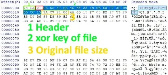

xor_key (16 byte): EB 16 0D DE E8 7E 0F 31 5E 98 B8 2D 04 E1 A3 02
// structure of encrypted file ..................
// 2     bytes 74 6A
// 1     bytes 21 | 65 | 7A
// 16    bytes of xor key xxtea
// 4     bytes size of original file
//       bytes total: 23
// other bytes data encrypted ...................
file structure
Algorithm decryption file
  1. Check 3 bytes header, if match do step 2
  2. Read next 16 bytes file_key and xor this with xor_key to get xxtea_key
  3. Decrypt data with xxtea xxtea_key to get original data
  4. If data[2] == 0x21 || data[2] == 0x7A then uncompress lz4
Example
xor_key   = EB 16 0D DE E8 7E 0F 31 5E 98 B8 2D 04 E1 A3 02
file_key  = 96 55 47 66 46 FF 23 18 0E EA 07 3D D8 55 CC 15 (in image)
xxtea_key = 7D 43 4A B8 AE 81 2C 29 50 72 BF 10 DC B4 6F 17 (xor_key ^ file_key)
data = raw[23:] xxxtea_decrypt(data, xxtea_key)

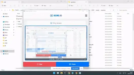

I'll make video RE with IDA remote android debugger to get xor_key when I have time
