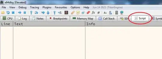

To launch a script, it has to be first loaded into x64dbg — then you will see it in the Script tab:
Before loading a script, the content of this tab is empty:

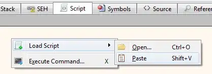

  2. The same, but using the context menu (Load Script → Paste):

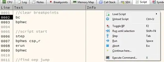

After loading the script (with any of the previous methods), you will see it in the Script tab, and you may launch it with the Space bar, or by commands in the context menu:
