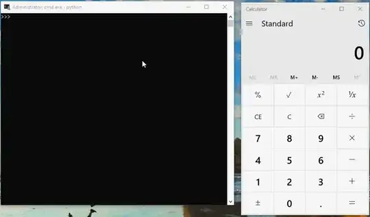

with this it is a single liner the Name ="New Note" is taken from your comments be aware the uwp app needs to be in foreground for this to work tooltip remark
:\>python -c "import uiautomation as auto;auto.ButtonControl(Seachdepth=1,Name =\"New note\").Click()"

  • My bad, I should have been more clear. When you open sticky notes, there's a button in the top left with the tooltip "New note" when you click that button, it opens a new sticky note. My goal is to to be able to be able to find the code that handles that button click, but call it from a different script, simulating someone clicking on that button. – DreamingInsanity Apr 22 '21 at 15:26
  • you cannot send keystrokes to a uwpapp look for uiautomation the sdk tool inspect.exe has an action menu it has a DoDefaultAction() or Invoke() action clicking that will normally result in actions like hitting enter on the focussed ui element – blabb Apr 22 '21 at 21:48
  • That's actually really helpful, thank you! It might now be possible to do what I want to do. – DreamingInsanity Apr 23 '21 at 15:37
  • I edited the answer to point to a possible readymade solution take a look – blabb Apr 23 '21 at 20:46
