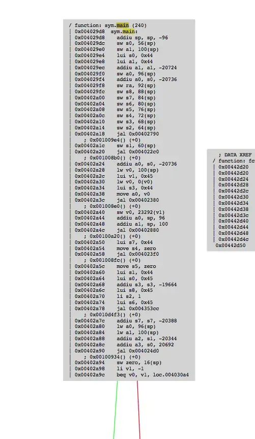

As an example, using radare2 as an example, on the Debian MIPS binutils port:
$ file bin/objdump
bin/objdump: ELF 32-bit MSB  executable, MIPS, MIPS-II version 1 (SYSV),
dynamically linked (uses shared libs), for GNU/Linux 2.6.26,
BuildID[sha1]=d1d228509874377d7339cfd5b2f15db020e53b7b, stripped
Following this example, we get something like this:
[0x00403300]> [email protected]
[0x00403300]> ag > foo.dot
foo.dot created
[0x00403300]> !dot -Tpdf -o foo.pdf foo.dot
[0x00403300]> !open foo.pdf
Part of the graph
Note that the PDF this churns out is enormous, so you might want to just use pdf instead of ag produce textual output rather than dot files.
