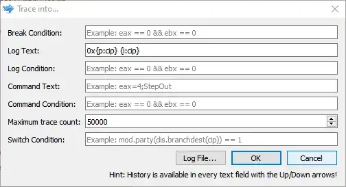

As far as I understand reading your comments - you want to log all the executed instructions in the file. To do this you need to:
  1. Pause the program, either via Pause option (F12) or using breakpoints
  2. Select Trace menu and then Trace into... (Ctrl+Alt+F7) or Trace over... (Ctrl+Alt+F8). If you want to log every instruction you probably want to use Trace into...
  3. Now in the newly created window Trace dialog
you can select the Log Text format, you can use the proposed 0x{p:cip} {i:cip} which will log the data to file like 0x006E8749 mov ebp, esp. It is also good idea to set the Maximum trace count and the Log File... where the data will be stored. After you are done just press OK and the x64dbg will start executing your program and log all the instructions. Keep in mind that the program won't work really fast during the trace procedure.
morsisko
  • 696
  • This is not the recommended method of doing this anymore. You can use the trace tab to do this natively from x64dbg. – mrexodia May 30 '20 at 20:52
  • @mrexodia But can you log the instructions to file with your own format using trace tab? – morsisko May 30 '20 at 21:58
    When you start the trace everything is logged to a file, you can open this file later from x64dbg again – mrexodia May 31 '20 at 02:44
