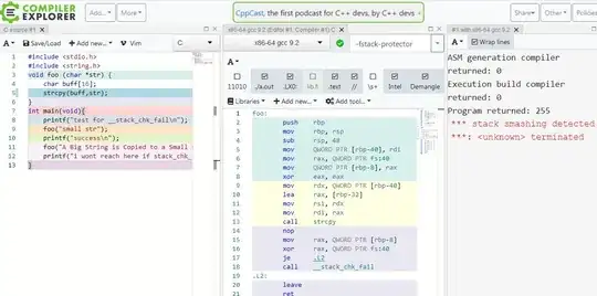

go to compiler explorer
paste this code select language as c
leave the compiler version as latest
add -fstack-protector to compiler options
and look at the disassembly produced to see how stack_canary @ fs:0x28 is used

disassembly of above code
foo:
        push    rbp
        mov     rbp, rsp
        sub     rsp, 48
        mov     QWORD PTR [rbp-40], rdi
        mov     rax, QWORD PTR fs:40
        mov     QWORD PTR [rbp-8], rax
        xor     eax, eax
        mov     rdx, QWORD PTR [rbp-40]
        lea     rax, [rbp-32]
        mov     rsi, rdx
        mov     rdi, rax
        call    strcpy
        nop
        mov     rax, QWORD PTR [rbp-8]
        xor     rax, QWORD PTR fs:40   <<<<(40=0x28)
        je      .L2
        call    __stack_chk_fail
.L2:
        leave
        ret
a screenshot showing what is said above to address the comment
