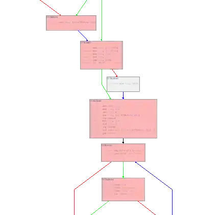

When I execute a program using IDA's debugger interface, I would like to see the basic blocks that were executed highlighted in the IDB. Is there a way to do this?

Process Stalker is designed to do exactly what you want.
Snippet of Process Stalker's basic block highlighting
Sample usage: https://www.openrce.org/articles/full_view/12
PowerPoint slides: http://2005.recon.cx/recon2005/papers/Pedram_Amini/process_stalking-recon05.pdf
