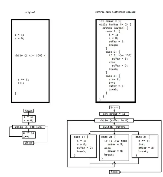

From this paper by Timea Laszlo and Akos Kiss :
The basic method for flattening a function is the following.
First, we break up the body of the function to basic blocks, and then we put all these blocks, which were originally at different nesting levels, next to each other.
The now equal-leveled basic blocks are encapsulated in a selective structure (a switch statement in the C++ language) with each block in a separate case, and the selection is encapsulated in turn in a loop.
Finally, the correct flow of control is ensured by a control variable representing the state of the program, which is set at the end of each basic block and is used in the predicates of the enclosing loop and selection.
Image showing how control-flow flattening obfuscation alters code that contains loop structures.
A simple example:
int original()
    print "Do"
    print "you"
    print "like"
    print "milk?"
int obfuscated() { int ctrFlowVar = 1;
while(ctrFlowVar != 0)
    switch(ctrFlowVar)
        case 1:
            print "do"
            ctrFlowVar = 2;
            break;
        case 2:
            print "you"
            ctrFlowVar = 3;
            break;
        case 3:
            print "like"
            ctrFlowVar = 4;
            break;
        case 4:
            print "milk?"
            ctrFlowVar = 0;
            break;

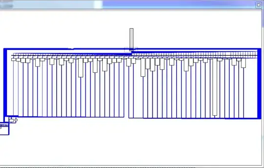

For a good example of this obfuscation, check Apple's FairPlay code, e.g. iTunes or iOS libs. Here's a typical graph of a function which had this obfuscation applied:
As you can see, all edges between basic blocks - both conditional and unconditional - has been redirected to a dispatcher node which uses a new artificial variable to decide which block should be jumped to next. This variable is updated at the end of each separated basic block.
Here's the dispatcher node:

Recovering it shouldn't be too difficult in most cases - just track the control variable updates and replace jumps to the dispatcher node with jumps to the next block corresponding to the new control variable value.
