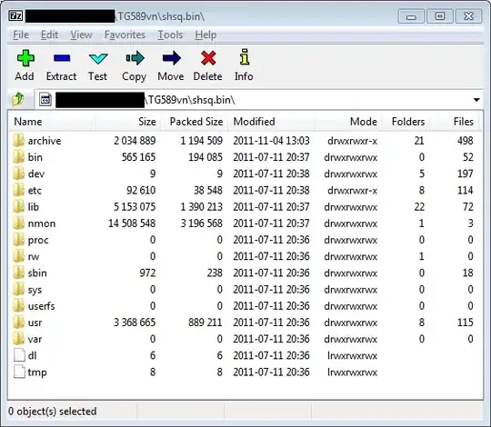

0x73687371 is apparently a magic value used to indicate LZMA compression by some vendors.
I can't test it since I don't have the image but here's a blog post with some description and source code links which is supposed to handle it:
http://www.poppopret.org/?p=204
EDIT: after some struggle with the download site I was able to get the decrypted shsq binary. I could open it easily with 7-Zip 9.21 beta:
Presumably any later versions will work too.
You can find the source code for handling SquashFS in 7z922.tar.bz2, file CPP/7zip/Archive/SquashfsHandler.cpp so you can try to figure out why it works and what's wrong with other approaches.

  • Hi Igor, thanks for your response but as you can see I posted a comment in that blog (Last comment) but that solution didn't work for me. – Nucklear Jun 08 '13 at 09:41
Try the patch from: http://sourceforge.net/p/squashfs/patches/20/
It seems to work ok on an X86_64 Debian installation.
