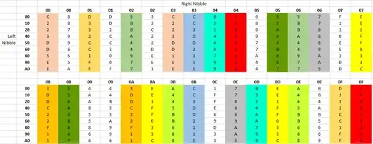

I have looked further into the left and right nibble of the second byte (the last byte is unchanged at 0x02). There seem to be repeated patterns depending on the values which I highlighted in Excel: Nibble Patterns
The colours highlight where there is repeating values. Not sure if this helps!
