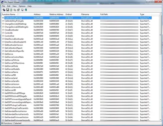

I have an unknown .dll from another program which I want to work with. With DLL Export Viewer I was able to find the exported functions.
But to call them I need the information about the parameters and the return type.
  • Is there an easy way to identify them in the disassembly?
  • Do tools exist which can extract those prototypes, or help me in a way?

From the output your screenshot shows, it looks like the names aren't mangled/decorated. This suggests - but is not conclusive proof - that the functions use the stdcall calling convention (better yet read this one by Ange, one of the moderators pro temp here). Now I don't know how much you know, but since you attempt RCE you are probably well-versed in calling conventions. If not let's sum it up like this: calling conventions govern how (order, alignment) and by what means (registers, stack) parameters get passed to functions. We'll get back to this in a moment. If you are on x64 Windows and the DLL is 64bit as well, you can rely on the Microsoft x64 calling convention (read this article).

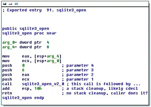

If you happen to have IDA and you analyze a 32bit DLL, chances are that IDA already identified the number of parameters and the calling convention using its heuristics. Let me demonstrate (using sqlite3.dll). In the Exports tab find a function you're interested in and double-click it. This will take you to the address where the function starts (here sqlite3_open).
As you can see IDA readily found that the function takes two arguments (you can look at the SQLite3 docs to verify this finding). However, there is another thing here. After the call sqlite3_open_v2_0 we can see that the stack pointer is adjusted by 10h (=16) thereby cleaning up four parameters. Looking at the push instructions before the call we can see that indeed four 32bit (i.e. DWORD) parameters are passed via the stack. Since there is no further cleanup on part of the function sqlite3_open itself, it is now clear that it is likely following the C calling convention (cdecl) as well. Again we can verify the finding (a benefit you won't have) by looking at the documentation. And indeed since no explicit calling convention is given, you end up defaulting to cdecl. The single retn (some disassemblers will show ret), meaning return, also doesn't clean up the stack, since otherwise it would look like retn 8 or similar.
This is a rather small function, but even with the circumstantial information we are able to deduce a lot about it.
