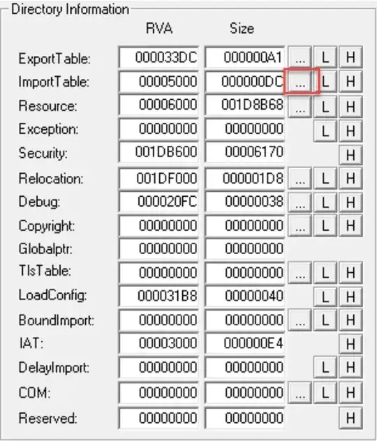

Then click Directories: enter image description here
Click the Ellipsis button next to Import Table: enter image description here

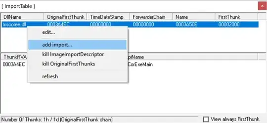

Right Click and choose add import: enter image description here

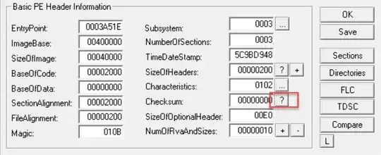

Press OK and then SAVE. Although not required you can correct the PE checksum with the ? button (and save afterwards): enter image description here
Note that adding the import doesn't mean that the executable loading your dll calls the export specified. It just means that the dll will be loaded and it's DLLMain will be called.
