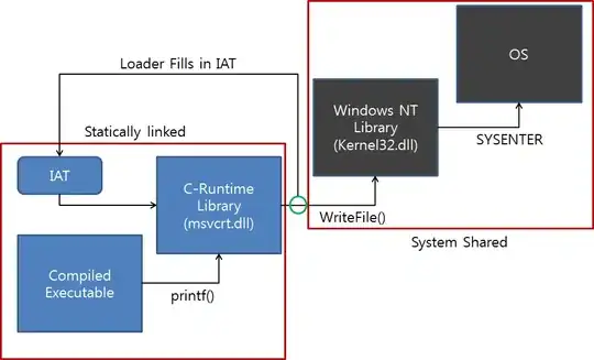

And the actual function body of WriteFile is in kernel32.dll. So, even if I link the C-runtime library statically, the binary doesn't contain the entire routine including the SYSENTER, or INT 0x2E instructions... The core part is still in a DLL. The following diagram describes how I understand it:
What I want is to statically link EVERYTHING into single EXE file. Including kernel32.dll, user32.dll to eliminate the necessity of loader parsing the IAT and resolving the function names.

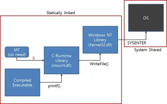

The following picture describes what I want:
I understand this is simple in Linux with gcc. All I have to do is give the option -static
Is there any option like this in VS2010? Please correct me if I'm misunderstanding.

    The answer is clearly "no". You would have to write your own OS specific syscall layer. The question is: why don't you want to use a standard CRT? To what advantage? – newgre May 22 '13 at 08:37
    thank you. in fact, I was not looking for performance advantage. I thought, in this way, I can remove every symbols just like Linux stripped binary and make the reversing harder. – daehee May 22 '13 at 10:42
    @daehee: that gives your question a whole different angle, you see. – 0xC0000022L May 22 '13 at 16:39
    Your description is correct, overall, but you need to add yet another layer, the NT native api: fread(msvcrt) -> ReadFile(kernel32) -> NtReadFile(ntdll.dll) -> kernel – Lorenzo Dematté May 23 '13 at 08:34
    With enough effort you might be able to do inline windows functions, but then you're bound to that specific windows version, and you'd probably violate MS's copyright. – CodesInChaos Sep 20 '13 at 10:43
