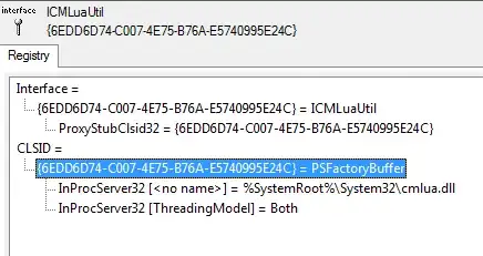

But in your case you already used oleview.exe and therefore knew the most important information:
Information shown in cmlua.dll for ICMLuaUtil
... which is why I found your comment confusing:
Unfortunately I couldn't do the same thing with ICMLuaUtil as I don't know the interface name, I tried several name variations but got nothing.

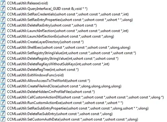

Now having found cmlua.dll to be the DLL to implement our (COM) object of interest, we can go ahead and load that into IDA (or another disassembler) and we will get prompted to load the debug symbol from Microsoft's symbol servers.
And once the symbols are loaded we get to see this:
excerpt of IDA's understanding of the cmlua.dll functions with debug symbols applied
Looks familiar?
To get the IDL you need to match the vtable of the CCMLuaUtil class to the interface pointer its DLL returns when asked for that specific class. Looking into DllGetClassObject will enable you to figure out the IID.
Now from here on this is going to be the same old grunt job of making sense of the disassembly (or the pseudo code if you can afford the decompiler plugin).
Now if we get lucky we can save a whole lot of time if the COM server (typically a DLL) in question contains a TYPELIB resource, which is the compiled version of an IDL and therefore the best starting point to get to an IDL quickly. For cmlua.dll we're out of luck, however.
Furthermore if you had no symbols like with Windows components, you would have to dig yourself into the disassembly starting from DllGetClassObject which is well-known and well-documented and should be trivial to understand even for the layperson. Going from there and equipped with the knowledge that the three first methods of any COM interface are inherited from IUnknown you'd then try to make sense of the implementation of each method (apart from those well-known first three) and assign hopefully meaningful names to the functions and their parameters. That is: the whole task becomes a bit more tedious without debug symbols, but not at all impossible.

CMLuaUtil_interface
There are many advantages of the assembly view. In the assembly view, all the methods in that class are placed in actual order but the functions windows may not (according to settings). The methods are actually placed as function pointers. For 64 bit binary there will be dq (qword 8 bytes) before every methods (in the above screenshot). The first three methods are inherited from IUnknown interface. If you are writing that class (as struct) in C, you've to include those three.
