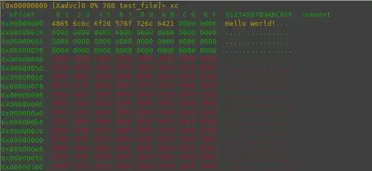

Create an input/output mapping to allow writing to a non-mapped file
To allow writing up to 64 byte starting at offset 0x00000000, map changes in radare2 to file descriptor 3 (the file opened in radare2).
[0x00000000]> om 3 0x0 64
[0x00000000]> om
1 fd: 3 +0x00000000 0x00000000 - 0x0000000b rwx
Explanation
An empty file (as created by touch) has no input/output mappings (even when opened with in write mode). To confirm no region has been mapped, you can list all defined IO maps with the radare2-command om.)
To create an i/o-mapping use om with parameters:
om fd vaddr [size] [paddr] [rwx] [name] create new io map
Example
radare2 -w test_file
 -- What has been executed cannot be unexecuted
[0x00000000]> w This won't be written anywhere, because no mapping exists.
[0x00000000]> om
[0x00000000]> om 3 0 64
[0x00000000]> om
 1 fd: 3 +0x00000000 0x00000000 - 0x0000003f rwx
[0x00000000]> w Hello World!
[0x00000000]> V
hexview of file after mapping and writing
