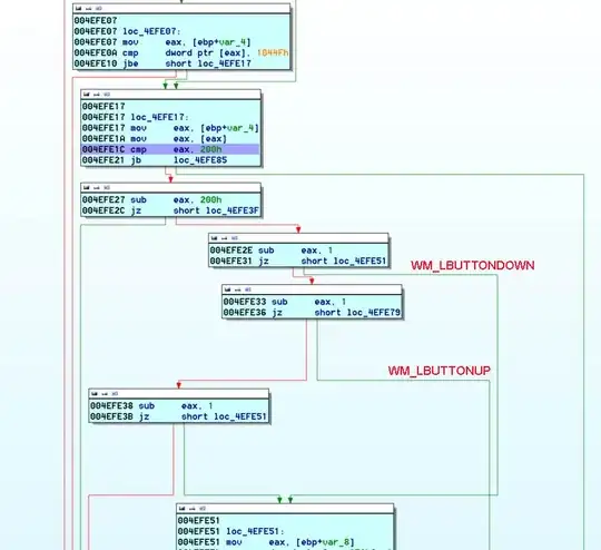

However, although this is a special case, I assumed normal "generic" windows message behaviour. In that case I can expect somewhere a WM_LBUTTONX message, X being UP or DOWN, with values 0x201 or 0x202. Thus I searched statically for the value 200h in Ida, this being the start of the "Mouse group" in the Windows WM_ messages set.
There are a number of locations found where a compare is made with 0x200. On these I set a breakpoint. Two of these are hit on mouseclicks, and one of them investigates explicitely 0x201 (WM_LBUTTONDOWN) and 0x202 (WM_LBUTTONUP):

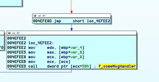

If you step futher down the WM_LBUTTONUP path you come directly to the following location, with a call to f_someMsgHandler (as I called it):

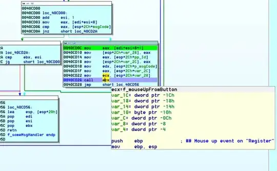

This function is called on several occasions, but the one corresponding to the mouse event is easily found, e.g. by setting a selective breakpoint. In this function, the following location leads directly to the handler of WM_LBUTTONUP of the "Register" button, being located at address 0x4fead0 (that address unfortunately hidden in the tooltip):
