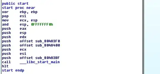

Here's how this commonly looks, using HTE for the screenshot:
HT Editor
The reason this is so convenient is because each hex digit represents exactly one nibble, that is 4 bits. So two hex digits can be used to represent a single 8-bit byte (the most common type of byte). Then showing them in multiples of 16 bytes per line has the additional advantage of making it easier to read the hexadecimal offset (given as 8-digit hexadecimal number in front of the hex bytes in the screenshot above), because decimal 16 is 0x10. The most common notations for hexadecimal numbers are:

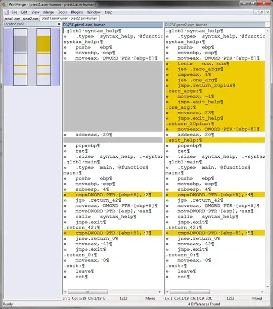

That's a mouthful. Now let's dig into one difference - aside from the "optimization" aspect - between this and a potential human-written piece of assembly that does the same. Here's what a human-written version might look like:

Anyone who has ever written assembly code will inevitably notice how I am not declaring variables (db, dw, dd) here. This would be the normal course of action, but of course here I was merely showing that we humans tend to give symbolic names to code locations (and variables). If you hand write assembly, it would look still different, I merely adjusted the code to look a bit more like what a human might write (i.e. it's not perfect and certainly not "hand-optimized"). The compiler will stubbornly and efficiently tack a number on some kind of lettered prefix and be done with it. Let's also create a possible human-written version of the first iteration, using the same names:

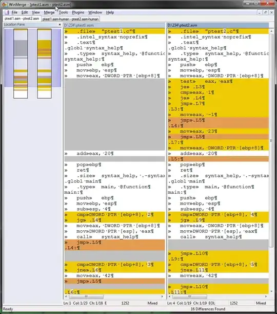

Comparing compiler-generated assembly code
Here's the output of diff ptest1.asm ptest2.asm (the compiler-generated form):
1c1
<       .file   "ptest1.c"
>       .file   "ptest2.c"
9a10,22
>       test    eax, eax
>       je      .L3
>       cmp     eax, 1
>       je      .L4
>       jmp     .L7
> .L3:
>       mov     eax, -1
>       jmp     .L5
> .L4:
>       mov     eax, 23
>       jmp     .L5
> .L7:
>       mov     eax, DWORD PTR [ebp+8]
10a24
> .L5:
20,21c34,35
<       cmp     DWORD PTR [ebp+8], 2
<       jg      .L4
>       cmp     DWORD PTR [ebp+8], 4
>       jg      .L9
25,28c39,42
<       jmp     .L5
< .L4:
<       cmp     DWORD PTR [ebp+8], 3
<       jne     .L6
>       jmp     .L10
> .L9:
>       cmp     DWORD PTR [ebp+8], 5
>       jne     .L11
30,31c44,45
<       jmp     .L5
< .L6:
>       jmp     .L10
> .L11:
33c47
< .L5:
> .L10:

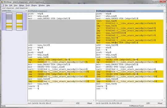

Not exactly helpful to understanding the differences, is it?
WinMerge provides a more visual result. Chaos ensues ...
WinMerge diff of ptest1.asm and ptest2.asm
NB: I decided to not doctor a full height screenshot, instead pay attention to the left pane which highlights the differences (yellow) and missing blocks (gray) and moved blocks (brown...ish).
Comparing "human-written" assembly code
Here's the output of diff ptest1.asm-human ptest2.asm-human ("human-written" form):
6a7,19
>       test    eax, eax
>       je      .zero_args
>       cmp     eax, 1
>       je      .one_arg
>       jmp     .return_20plus
> .zero_args:
>       mov     eax, -1
>       jmp     .exit_help
> .one_arg:
>       mov     eax, 23
>       jmp     .exit_help
> .return_20plus:
7a21
> .exit_help:
17c31
24c38
Whoa, that's actually almost readable. Use colordiff and it's useful.
The respective visual comparison in WinMerge looks downright readable:
WinMerge diff of ptest1.asm-human and ptest2.asm-human

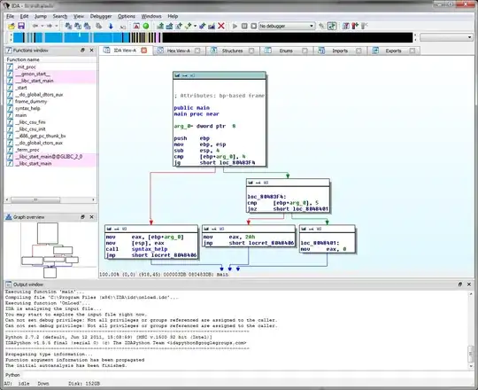

Interlude - basic blocks
A disassembler can only be smart to a certain extent, because it's a program. Even IDA Pro, hands down the most advanced disassembler as of this writing, will not be able to guess everything right - e.g. when distinguishing code or data. But the more sophisticated tools do a pretty good job at it. And IDA adds the I as interactive.
One thing disassemblers encounter are what assembly programmers is known as labels and (sub)routines.
Labels, although they exist in C and are (rightly) frowned upon together with goto, also exist in higher level language, but tend to cover a somewhat different concept. Perhaps the closest to the assembly language concept were the labels in the good old days of BASIC. When you compile C into assembly code, however, every condition gets translated into a conditional or unconditional jump (jmp, je, jg, jne in the above compiler-generated code). The jump targets are referred to as labels. The jumps are the places where the code branches conditionally or unconditionally.
The closest corresponding concept to a routine would be a function in C or the procedure/function in Pascal or the sub in BASIC.
More or less each of the chunks of code between two branching instructions, other than call, are called basic blocks. In IDA Pro this is neatly visualized in the graph view (can be toggled with flat view via default Space):
IDA Pro graph view demonstrating a visualization of basic blocks
Each of the blocks linked by the arrows in the main IDA-view would be a basic block.

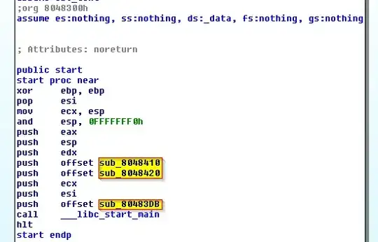

Just to give you an idea, I generated an .asm file using IDA, stripped it down to everything without comments and empty lines and still ended up with 362 lines, as opposed to 52 lines in the original compiler-generated assembly which included meta-data used by the linker. This whopping difference can of course be attributed to the linker adding all kinds of code required to initialize the executable. In fewer words: it's boiler plate code the compiler (or more precisely its linker) adds.
For this comparison I am going to leave out this boiler plate code entirely, although obviously this only adds to the complexity a diff tool will encounter when comparing binary executable code.
Unlike in the IDA screenshot above, which shows ptest2.c disassembled, in reality you will mostly have to work without debug symbols. This means the names such as main and syntax_help will no longer exist. Instead disassemblers such as IDA Pro mostly resort to naming the routines after their offset (e.g. sub_80483DB). It applies the same for labels (i.e. naming those loc_80483F4 or locret_something). Of course the reverse engineer is free to change these names to something more readable/recognizable for herself. But the default names still depend on the offset.
In fact the disassembler will have a hard time to identify the main function, because the aforementioned boiler plate code tends to come before it when looking at it starting from the entry point of the executable. Here's what IDA shows you if there are no symbols available to the compiled ptest2.c from before (i.e. ran strip -s ...):
IDA Pro showing the entry point of compiled <code>ptest2.c</code>
Now let's look at the entry point for the compiled (and stripped) ptest1.c as well:

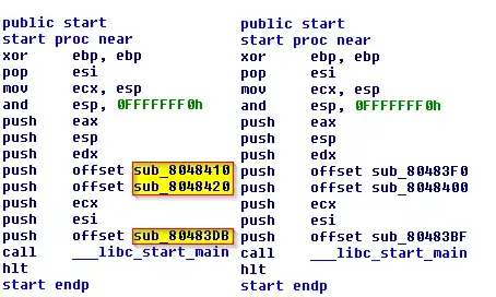

Do you notice the difference? It's subtle, but let me put them side to side for you:
Side by side comparison
Yes, the highlighted lines ... ooh the offsets differ. What does that mean?
Well, it means that the symbolic names IDA Pro assigns to routines and also to labels (i.e. basic blocks) will differ based on the offset of these entities within the file.
This is very similar indeed to what we encountered before with the compiler-generated assembly code and the numbered label names.

Let's compare the relevant pieces of code created by a simpler disassembler in a text differ.
Using objdump -M intel -d ... and then getting rid of the leading offsets and spaces we get this for the relevant parts in WinMerge:
WinMerge of the disassembly created with objdump
Full commands were:
objdump -M intel -d ptest1.stripped|grep '^ 80'|cut -f 2- -d ':'|sed 's/^\s*//g'
objdump -M intel -d ptest2.stripped|grep '^ 80'|cut -f 2- -d ':'|sed 's/^\s*//g'
