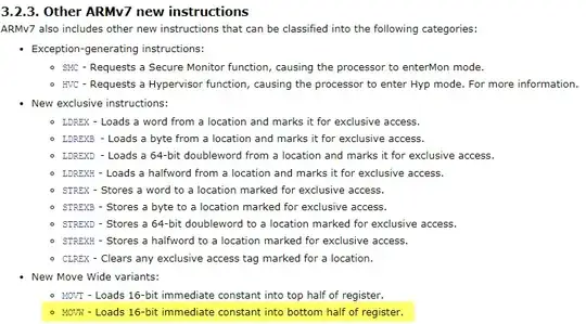

However, running under a ARMv6 QEMU VM it crashes with an Illegal instruction, similar to yours. Digging deep there're indeed some instructions which are invalid under ARMv5.

Above it crashed on the movw r12, #0 at 0x20c1b38. Now the movw was introduced in ARMv7 and unavailable in ARMv5. Similarly the movt instruction is also invalid under v5.
Image Source
This explains why ARM v5/v6 qemu is crashing. So to run the binary you would atleast need an ARMv7 QEMU vm or the Raspberry Pi 2 which sports an ARMv7 processor.
