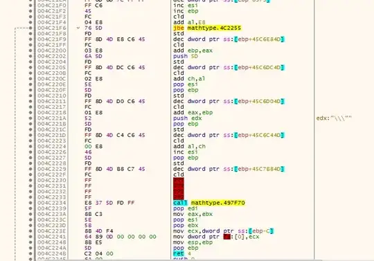

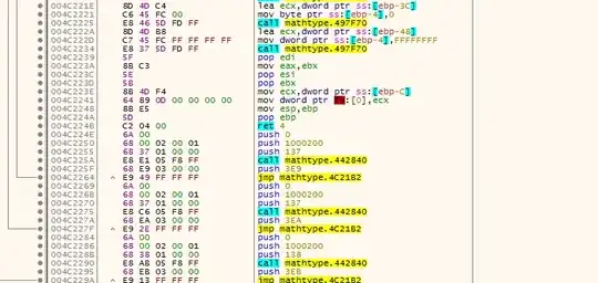

I was just wondering if there was a way to force an interpretation of a block of code in x64dbg.
The section im analyzing fluctuates between this:
and this:

  • It's not quite clear what are you asking. Please clarify your question and what you want to achieve. Also, please mention what you already tried. – Megabeets Jun 15 '18 at 12:16
  • My question might be completely bogus - I'm not too sure but essentially: When i scroll up and down, sometimes sections of code appear as data instead of commands and they seem to swap. Is there any way for me to force x64dbg to interpret a section as code in a specific way so that instead of interpreting it like this: https://puu.sh/AFKL1/46fcdf5c8d.png
    it is interpreted as this: https://puu.sh/AFKMI/5259abad45.png
    (I tried to get the same addresses)
    – Xymistic Jun 15 '18 at 12:41
  • I haven't tried much either because I'm not too sure what exactly is happening (why the code interpretation changes?). – Xymistic Jun 15 '18 at 12:48
  • Seems like the code isn't aligned correctly. Give a try to right-click and then choose an option from the "Analysis" menu. For example, "Analyze module (CTRL+A)" – Megabeets Jun 15 '18 at 13:14
  • Thanks for the suggestion, however analysing the module doesn't seem to help. – Xymistic Jun 15 '18 at 13:59
