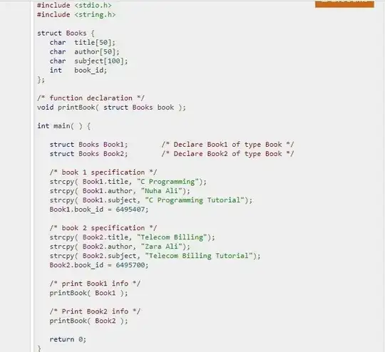

I am having trouble understanding working with structs in assembly from disassembly. can you please explain the code below. Disassembly below:
disassembly snippet
Source code:
source code snippet

This is manual string assignment. Notice how all DWORDs are composed of printable characters? hit r in IDA to convert the hex values to string characters.
This code seems to be assigning strings into different stack addresses, 4 characters at a time. This is a common optimization over calling a function that iterates over strings byte by byte.
As others pointed out, this optimization is usually called "loop unrolling" as it unrolls several iterations of a loop into sequential assembly, however I often find that type of direct string characters assignment to be more commonly the output of a code similar to the following:
char str[] = "this is a string";
NirIzr

This is called inlining. strcpy was substituted by mov instructions, because compiler decided that in such way code will run faster.

the optimizations mantras of the answers got me intrigued so i thought i'll check what actual optimizations are being done on the code (OP appears to be beginner and i doubted OP would be capable of optimizing at all )
it appears this is default compilation without optimization enabled in gcc
gcc version 8.1.0 (i686-win32-dwarf-rev0, Built by MinGW-W64 project)
visual studio 2017 15.7.3 doesn't do this kind of code at all whether optimized or not
with optimizations disabled vs resorts to calling strcpy ()
:\>cl /nologo /Zi booky.cpp
booky.cpp
:\>cdb -c ".lines;uf booky!main;q" booky.exe | grep -E "  15|  16|  17"
   15 001c6b35 6850be2100      push    offset booky!__xt_z+0x108 (0021be50)
   15 001c6b3a 8d8530ffffff    lea     eax,[ebp-0D0h]
   15 001c6b40 50              push    eax
   15 001c6b41 e86bb2ffff      call    booky!ILT+3500(_strcpy) (001c1db1) <<<<
   15 001c6b46 83c408          add     esp,8
   16 001c6b49 685cbe2100      push    offset booky!__xt_z+0x114 (0021be5c)
   16 001c6b4e 8d8d62ffffff    lea     ecx,[ebp-9Eh]
   16 001c6b54 51              push    ecx
   16 001c6b55 e857b2ffff      call    booky!ILT+3500(_strcpy) (001c1db1) <<<<
   16 001c6b5a 83c408          add     esp,8
   17 001c6b5d 6868be2100      push    offset booky!__xt_z+0x120 (0021be68)
   17 001c6b62 8d5594          lea     edx,[ebp-6Ch]
   17 001c6b65 52              push    edx
   17 001c6b66 e846b2ffff      call    booky!ILT+3500(_strcpy) (001c1db1)  <<<<
   17 001c6b6b 83c408          add     esp,8
optimising for space (O2) or full optimisations (Ox) vs2017 resorts to using sse2 moves
:\>cl /Zi /O2 booky.cpp
Microsoft (R) C/C++ Optimizing Compiler Version 19.14.26430 for x86
   15 00f7aae4 a158befc00      mov     eax,dword ptr [booky!`string'+0x8 (00fcbe58)]
:\>cdb -c ".lines;uf booky!main;q" booky.exe | grep -A 5 -E "  15|  16|  17"
   19 00f7aae9 b933000000      mov     ecx,33h
   19 00f7aaee f30f7e0550befc00 movq    xmm0,mmword ptr [booky!`string' (00fcbe50)] <<<<<<<<
   19 00f7aaf6 89442408        mov     dword ptr [esp+8],eax
   19 00f7aafa 0fb60568befc00  movzx   eax,byte ptr [booky!`string'+0x8 (00fcbe68)] <<<<<<<
   19 00f7ab01 8844243a        mov     byte ptr [esp+3Ah],al
:\>cl /Zi /Ox booky.cpp
   15 0138ac74 a198e83d01      mov     eax,dword ptr [booky!__newctype+0x308 (013de898)]
   19 0138ac79 b933000000      mov     ecx,33h
   19 0138ac7e f30f7e0590e83d01 movq    xmm0,mmword ptr [booky!__newctype+0x300 (013de890)]
   19 0138ac86 89442408        mov     dword ptr [esp+8],eax
   19 0138ac8a 0fb605a4e83d01  movzx   eax,byte ptr [booky!__newctype+0x314 (013de8a4)]
   19 0138ac91 8844243a        mov     byte ptr [esp+3Ah],al
mingw gcc 8.10 seems to break the strings into dwords even when explicitly disabling optimization with O0
:>e:\mingw\mingw-w64.bat
:>ls
booky.cpp
:>gcc -g -O0 booky.cpp
g++ -g -O0 also disassembles to same construct as below
:\>objdump -d --start-address 0x4015c0 --stop-address 0x401600 -M intel a.exe
a.exe:     file format pei-i386
Disassembly of section .text:
004015c0 <_main>:
  4015c0:       55                      push   ebp
  4015c1:       89 e5                   mov    ebp,esp
  4015c3:       57                      push   edi
  4015c4:       56                      push   esi
  4015c5:       53                      push   ebx
  4015c6:       83 e4 f0                and    esp,0xfffffff0
  4015c9:       81 ec 70 02 00 00       sub    esp,0x270
  4015cf:       e8 ec 01 00 00          call   4017c0 <___main>
  4015d4:       8d 84 24 a4 01 00 00    lea    eax,[esp+0x1a4]
  4015db:       c7 00 50 72 6f 67       mov    DWORD PTR [eax],0x676f7250
  4015e1:       c7 40 04 72 61 6d 6d    mov    DWORD PTR [eax+0x4],0x6d6d6172
  4015e8:       c7 40 08 69 6e 67 00    mov    DWORD PTR [eax+0x8],0x676e69
  4015ef:       8d 84 24 a4 01 00 00    lea    eax,[esp+0x1a4]
  4015f6:       83 c0 32                add    eax,0x32
  4015f9:       c7 00 4e 75 68 61       mov    DWORD PTR [eax],0x6168754e
  4015ff:       c7                      .byte 0xc7
to disable this -fno-builtin-strcpy needs to be passed to gcc in commandline if -fno-builtin-strcpy is passed gcc wont chunk the strings even when compiled with -O3 optimization
compilation
:\>ls
booky.cpp
:\>g++ -O3 -g -fno-builtin-strcpy -o booky.exe booky.cpp
:\>ls
booky.cpp  booky.exe
execution
:\>booky.exe
ProgrammingTelecom Billing
