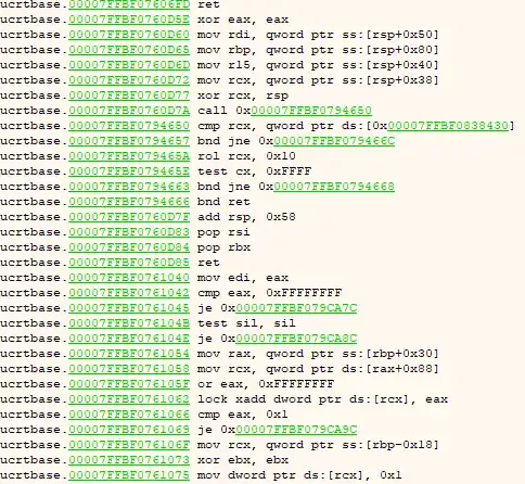

After clicking OK button, only instructions in the specified module will appear in the log panel and you should see something like this:
x64dbg_log
The only problem that is still to solve is to find the module entry address. I've done it by logging every module name and entry point until I find the relevant one. If I find any better way to do that, I will update my answer.
