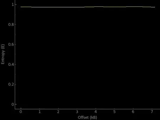

    For the example, I encrypted a file with Salsa20 (filled only with ABCDEFGHIJKLMNOPQRSTUVWXYZ strings). I got the following result:
    Entropy of a Salsa20 cipher
    Note that the obtained entropy is close to 1, which is exactly what is desired when we use any encryption algorithm.
