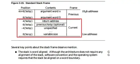

  • According to the SYS V i386 ABI the stack must be at minimum operating system word aligned prior to execution of the CALL instruction.
    Excerpt from Peter Cordes' answer to Responsiblity of stack alignment in x86 assembly:
    The i386 System V ABI has guaranteed/required for years that ESP+4 is 16B-aligned on entry to a function. (i.e. ESP must be 16B-aligned before a CALL instruction, so args on the stack start at a 16B boundary. This is the same as for x86-64 System V.)
  • Additionally, GCC aligns the stack to a 16-byte boundary by defualt. To accomplish this, GCC will allocate additional space in an area within a function's stack frame that is considered unrestricted by the ABI:
    Other areas depend on the compiler and the code being compiled. The standard calling sequence does not define a maximum stack frame size, nor does it restrict how a language system uses the ‘‘unspecified’’ area of the standard stack frame.
  • in the ABI the function return address is considered to be part of the current stack frame:
i386 stack frame layout
This is enough information to allow us to determine why the compiler generates code that creates unused space on the stack. Let us examine the code, focusing on instructions that result in stack frame memory allocation:

  1. We now know that the return address is considered to be part of the current stack frame. i386 machines have 32-bit architecture, so the return address takes up 4 bytes of space and execution of the instruction push ebp will decrement the stack pointer by 4 bytes.
    • 4 + 4 = 8, so at this point the stack frame is 8 bytes in size.
  2. As you noted, this creates 264 bytes of space.
    • 8 + 264 = 272
  3. sub esp, 8 - the specific instruction in question. Creates 8 additional bytes of space on the stack frame.
    • 272 + 8 = 280
  4. As before, push has the effect of adding 4 bytes of space.
    • 280 + 4 = 284
  5. Another push.
    • 284 + 4 = 288
  6. Now it is time for execution of the call instruction. At this point the stack frame is 288 bytes in size. Let us check for alignment to a 16-byte boundary:
    • 288 % 16 = 0 (thanks RadLexus). The stack frame is correctly aligned.
Conclusion:
The compiler uses sub esp, 8 to maintain stack frame alignment to a 16-byte boundary.
