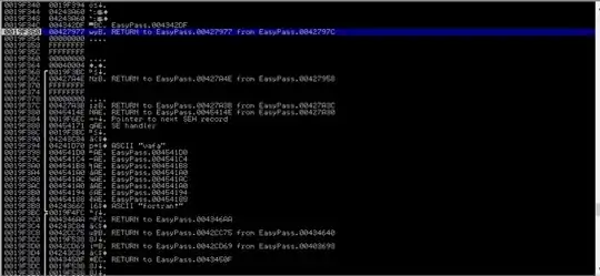

This is the stack view that I'm getting in radare2 after entering the visual panel mode:
This is the view from immunity debugger:
How can I get a view similar to immunity debugger in radare2?

You have several ways to print the stack. The specific way that you're searching for is called Stack Telescoping and you can print it like this:
pxr @ esp
Use sp, esp, and rsp according to your system.
pxr stands for Print heXadecimal References, you can see its description by using px?:
[0x7f8a672ee4]> px?
<...truncated...>
pxr[j]            show words with references to flags and code
Here are some other options to print the stack using radare2:
  • pxa @ rsp - to show annotated hexdump
  • pxw @ rsp - to show hexadecimal words dump (32bit)
  • pxq @ rsp - to show hexadecimal quad-words dump (64bit)
  • ad@r:SP - to analyze the stack data

  • Does it mean that I have to use a command after each step over to get an update on stack? – Kennet Celeste Nov 26 '17 at 15:45
    No, you can use Visual Panel Mode (v!) -- check out my answer here. If you want a view similar to PEDA's you can use e dbg.slow = true and then use Vpp. That's way you'll see a Visual Mode as well as Stack Telescoping. – Megabeets Nov 26 '17 at 15:50
  • Thanks! though I still can't scroll through the stack. When I use the arrow keys, it scrolls the code at the bottom of the page and the stack doesn't scroll. Do you know how to scroll through stack? – Kennet Celeste Nov 26 '17 at 17:31
  • In visual panel mode you can use Tab to move between the panels and h, J, k, and l to scroll inside the panel. – Megabeets Nov 26 '17 at 21:23
  • No I mean how to scroll in Vpp. in visual panel mode the stack is like the figure I posted. So scrolling isn't useful – Kennet Celeste Nov 26 '17 at 21:49
  • You can split the Visual screen, check out my answer here. – Megabeets Nov 26 '17 at 22:43
  • Thanks and sorry for multiple question. But still it doesn't work properly for me: the horizontal splitting does not show both right and left sides at the same time. It just shows the code and then when I press a button, it shows the stack (for which I used one of your commands above) just for a second and again it disappears. Have you had this issue? Have you actually tested the splitting with for instance ad@r:SP ? – Kennet Celeste Nov 26 '17 at 22:54
  • The way to do it was actually to enter the cursor mode with c and then tab to select stack, regs or disasm – Kennet Celeste Nov 27 '17 at 03:24
  • For a shorter version of the very long output, just mention write pxr 20r:SP – Solidak Aug 13 '18 at 07:20
