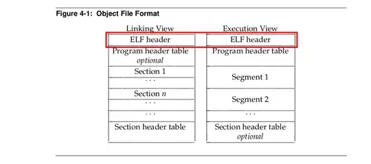

Here is a high-level overview of what is involved in locating information contained in an ELF binary's individual section headers. The documentation cited is for ELF32 binaries, but the process is the same with ELF64 binaries.
The location of the section header table is given in the ELF header:
ELF header location
The ELF header is a struct and the offset of the section header table is stored in a member called e_shoff:

The section header table is usually located at the end of the binary following all of the sections:
section header table location in binary
As stated in the documentation and mentioned previously, every section has an entry in the section header table. Each entry is a structure that contains information about the section, including its name and its virtual address when the binary is mapped into memory. The name of the section is stored in a struct member called sh_name, and the address information is stored in a struct member called sh_addr:
