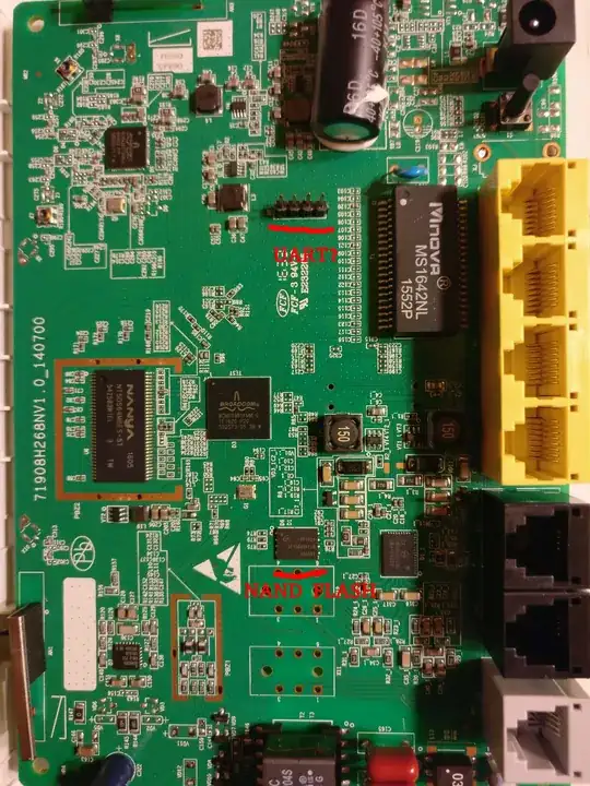

I have been reverse engineering ZTE Speedport Entry 2i for some time. Mostly trying to decode config (in ZTE encrypted backup config file) Honestly I didn't manage to find any firmware image on the Internet. This device is sold only as CPE to ISPs so I would really like to know where did you find that binary blob.
I checked your files, didn't manage to get anything from them unfortunately. My guess (and it's really just a guess) is that it may contain filesystem but since it's Chinese device the FS may be something proprietary.
The device has Broadcom BCM6338 so it's MIPS architecture. On the board you can notice 4 not mounted pins. You'll have to solder the pins there probably. I assumed this is UART, unfortunately it doesn't seem to work, when I connected to it before powering up, the device won't even start. If connected when powered up, nothing gets transmitted. The pins are connected to pins marked as TEST on the PCB. As Gogeta70 mentioned, using bus pirate with SPI sniffer it's possible to read FW from Flash. Device has GD5F1GQ4UAYIG NAND Flash memory (at least mine has). I'll update when my bus pirate arrives.
Here is picture of the PCB, for anyone interested. Speedport Entry 2i PCB

I also took a look in this router. The serial port works fine, yet the cfe bootloaded seems locked (while is booting dosen't give you the opportunity to stop the process). After the boot process they did provide a shell but they ask for login credentials. Which still don't know. I took a look at the firmware update. Extracting from the jffs2 partition didn't work very well for me. I see the formal linux structure (etc, root, bin ..) yet the only folder having files is the /bin which is not particular useful. Did anyone had any success extracting the /etc folder ? My guess at this point is that a nand flash dump is the way to proceed or a exploit in the web ui that can give us root and continue for there.
that the boot log:
