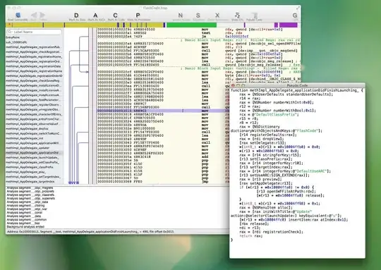

After decrypting an IPA file on a jailbroken iDevice, you can use a much more affordable alternative to IDA Pro called Hopper - the multi-platform disassembler for < $100.
https://www.hopperapp.com/
It has support for analyzing iOS executables (among others) and even comes with the ability to convert ARM assembly to pseudo-C.
Hopper screenshot with example disassembly and pseudocode
