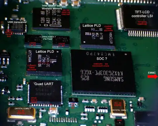

I have some difficult to find CPU from a board. First I though that CPU/SOC was this one :
All I know (about CPU) is that's an ARM core little-endian (because I begin reverse firmware in IDA) but I lack of information on it. The hardware is a 8 years old GPS with 800x480 tft.
According to Igor link document from Samsung, codification of K4X2G303PC - XGC6 means :

Here is the whole board (warning EMMC is unsolded) enter image description here enter image description here
Here same hard, but component is another reference from Micron Technology (picture is 180° rotated)
And the backside
X16V554IL is quad UART (https://www.exar.com/content/document.ashx?id=505) I checked GND pinout it is corresponding
So if Samsung K4x2G303PC is not SOC/CPU where is SOC/CPU ?
Why is there a Crystal near K4x2G303PC ? (The other Crytal is for XR16V) Can Latticle CPLD LC4064 have an arm software core ?
REgards ;)

    could it be that the CPU is somewhere else? what is this board from? – Igor Skochinsky May 06 '17 at 18:37
  • What are the two ICs between the Samsung RAM and the EMMC ? – Ian Cook May 11 '17 at 17:57

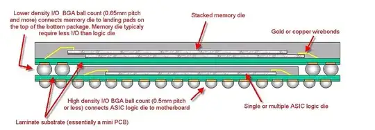

On this photo you can see there are two "layers" in this chip separated by a matrix of solder balls. This is package on package — a method used to save board space. The actual processor is hidden under the RAM chip.
Look at Raspberry Pi Zero — you won't find SoC there either! The chip there has Elpida label, which is a RAM manufacturer, and the SoC itself is under there.
Vladislav Ivanov
  • 619
  • This is it ! Amazing ! I didn't know. Knowing this I found this video : pop video at 1:45 min we can see approximately the same reference memory ( IBAI8 D9LFW <=> IBAI8 D9LBZ from Micro) and under the cpu chip... – user2296435 May 23 '17 at 06:57
Are you sure it's a SoC and that is the IC the firmware came from? Results on Google suggest that is a DRAM chip. Looking at Samsung part numbers show that most of the memory chips (mobile and otherwise) seem to start with K as well.
user1593858
  • 141
    Yes, it's consistent with the part numbers of their 2GB Mobile DDR SDRAM chips. I haven't found this specific one but other very similar parts seem quite common. e.g. K4X2G323PC or K4X4G303PC – Ian Cook May 06 '17 at 05:37
  • Yes THANKS, I think your are right. I find other reference for same hard (Micron Technologie) : IBAI8 on picture... They provide only DRAM, EMMC, NAND Flash but no CPU. So, it could be no SOC but just an Arm CPU ? Where is the Arm CPU ? Is it component reference XR16V ??? – user2296435 May 06 '17 at 10:03
  • Meanwhile, I think that X16V554 is quad UART (https://www.exar.com/content/document.ashx?id=505). SO I don't understand where is CPU ? – user2296435 May 06 '17 at 11:21
You can use Samsung DRAM part number decoder to find out the exact specs of this DRAM chip.
So no, this is not the CPU, it must be somewhere else.

  • This is done. I updated description of subject with it. It seem this is just a DRAM. If thisis the case I don't understand why there is a crytal near it and where is cpu ? – user2296435 May 08 '17 at 16:49
  • good question, but I guess we need someone experienced in hardware to answer it. Maybe try to figure out JTAG, the chain scan might give the device IDs and from that some hints about the CPU. – Igor Skochinsky May 08 '17 at 16:58
  • another possibility could be to try tracing pins of DRAM and/or eMMC to see where they connect to. – Igor Skochinsky May 08 '17 at 17:00
  • I have tryed open-ocd on pins that seems JTAG header with no result. I will try a JTAG finder later. Perhaps il will unsolder chipset. But for now this is a mystery – user2296435 May 08 '17 at 19:01
