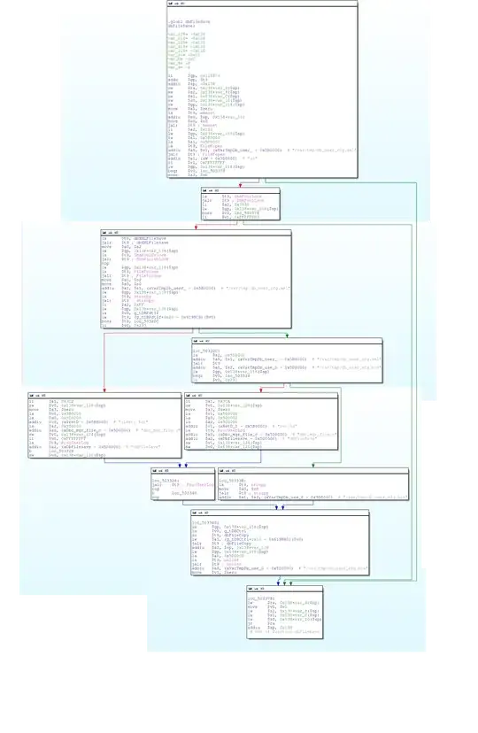

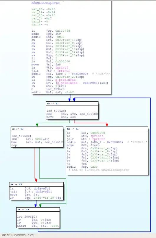

EDIT3: On my router ZTEZXV10 H201L V2 there is a utility which is in charge of db dackup (its called cspd) and here it is so maybe someone can "see" how the backup is encrypted: DBbackupXML
And here is dbFileSave. I can't tell which is responsible for saving the file. enter image description here Do you have any suggestions as to what I should try ?

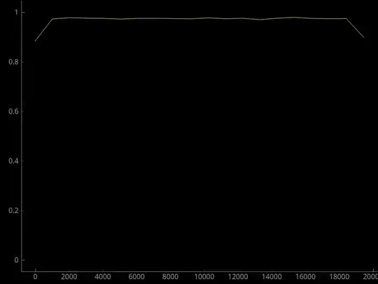

This is the result of using Binwalk to perform entropy analysis of H201LV2.0_Cur_config.bin:
$ binwalk -E -J H201LV2.0_Cur_config.bin
DECIMAL       HEXADECIMAL     ENTROPY
1024          0x400           Rising entropy edge (0.972587)
entropy 1

Synopsis: According to the graph, entropy distribution between byte offsets (decimal) ~1000 to ~19000 is fairly uniform. This is expected with encrypted data:
Encrypted data is typically a flat line with no variation
The chi square distribution is 650.33 and the pi error is 0.26. The chi square value is on target for what is expected with encrypted data but the pi error value is very far off target, according to devttys0:
Higher chi values (> 300) with lower pi errors (< .03%) are indicative of encryption.
Part of the problem is the small file size of ~20KB and low entropy in the file header, which we know is not encrypted. Excluding data known to be unencrypted from analysis will increase accuracy. Encryption looks like it begins at around offset 0x00000124, so a python script can be written to skip past the first 292 bytes and write the rest to an auxiliary file:

Arithmetic mean value of data bytes is 128.0505 (127.5 = random).
Monte Carlo value for Pi is 3.143651529 (error 0.07 percent).
Serial correlation coefficient is 0.011183 (totally uncorrelated = 0.0).
These results are interesting: the graph indicates approximately uniform entropy throughout the file, but now the chi square distribution (256.03) and the pi approximation error (0.07%) are both within the bounds of what is expected for compressed data!
Lower chi values (< 300) with higher pi error (> .03%) are indicative of compression.
With that said, these new values are relatively close to their respective boundary conditions. That is, 256.03 is relatively close to boundary condition of 300 for the chi square distribution and 0.07% is relatively close to the boundary condition of 0.03% for pi approximation error, so it is difficult to say with confidence that the file really is encrypted or if it is compressed based on this.
Conclusion
Evidence supporting the hypothesis that the file is encrypted is confounded by some of the results of the entropy analysis. Therefore I will venture that the file is encrypted but I cannot prove it using the methods I described here.
I hope that these findings (or lack thereof) will prove useful to others performing their own investigation of this file. Perhaps a professional will be able to definitively answer this interesting question.

quick update:
these encryption libraries are dynamically linked to the cspd MIPS ELF binary:
$ readelf --dyn-syms cspd | grep AES
   484: 0053ab50  1248 FUNC    GLOBAL DEFAULT    8 AES_set_encrypt_key
   630: 0053b9d0  1600 FUNC    GLOBAL DEFAULT    8 AES_decrypt
  1187: 0050d470   552 FUNC    GLOBAL DEFAULT    8 DecryByAES
  1527: 0053b390  1600 FUNC    GLOBAL DEFAULT    8 AES_encrypt
  1535: 0053b030   864 FUNC    GLOBAL DEFAULT    8 AES_set_decrypt_key
as are these compression libraries:
$ readelf --dyn-syms cspd | grep compress
    92: 0053c110   208 FUNC    GLOBAL DEFAULT    8 uncompress
  1064: 0053c010   216 FUNC    GLOBAL DEFAULT    8 compress2
uncompress and compress2 are associated with zlib.

  • Im still investigating. There are numerous functions in the cspd ELF binary that have to do with saving db files or encryption. Im trying to find the link between these if there is any. Encryption by AES seems probable but i have not yet found at which point the encryption of the config file takes place – julian Mar 03 '17 at 16:59
  • Wll done @SYS_V here is function AES_set_encrypt_key http://www.upslike.net/image/5853W – Vido Mar 03 '17 at 17:18
  • How did you retrieve the config.bin and cspd files from the router? Does the router write them to a USB stick? – julian Mar 03 '17 at 17:24
  • No it does not write them to usb, I enabled ftp and copied them to /mnt/ via telnet and downloaded thru web browser – Vido Mar 03 '17 at 17:37

On my router ZTEZXV10 H201L V2 there is utility which is incharge for db dackup and hire it is maybe some one can "see" how they encrypt baykup
DBXMLSAVE

  • Thanks for sharing this information. Can you put it in the question? That way everyone will see it right away instead of having to scroll to the bottom of my very long post to see it – julian Mar 01 '17 at 18:30
  • I also posted here picture of dbcCfgFileDecry function – Vido Mar 11 '17 at 22:15
  • The encry function is also interesting. Can you make a new question asking how to decrypt the config.bin file and include the cspd ELF binary as well as information about interesting functions in it? The question here was about identifying the encoding of config.bin, so having a new question just about the encryption/decryption process in cspd might be a good idea – julian Mar 11 '17 at 22:23
