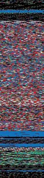

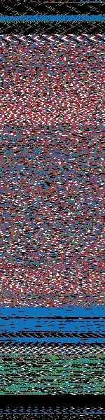

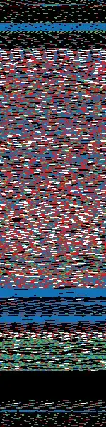

To make this more clear, below are visualizations of the Linux utilities ls, cat, mkdir and mv (accomplished via binvis.io). The solid blue areas consist of ASCII string data (the .rodata section, for example), and the large blocks of blue, white, red and black mixed together are regions that consist of executable code (the .text section, for example).
* ls cat mkdir mv
ls cat mkdir mv
As we can see from these visualizations, these binaries are organized in a similar fashion. Each binary has discrete areas, or sections, which contain different information. We can also see here that there are multiple areas (i.e. sections) containing ASCII string data, not just one.
