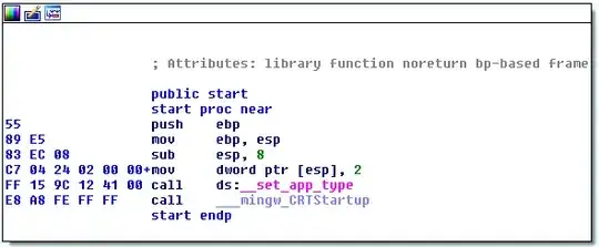

The easiest way to get this done is simply by opening the Options -> General -> Disassembly window, and setting the "Number of opcode bytes (Graph)" field to the number of opcode bytes you wish IDA to show you in the both the graph and linear disassembly listing views.
This is how the configuration change should look:
And the result of doing that will be similar to what's seen in the following image:
Note that at most 6 bytes are displayed, and a plus sign is used to indicate a specific opcode contains additional bytes.
