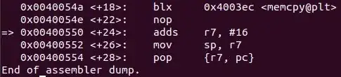

Put the breakpoint on the main and run. Still looks OK. I can put the breakpoint in the func1, just before returning from them:

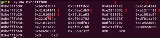

In this point, the stack should already be overwritten and after `pop', the program should branch to previously glued gadget address and start to execute the program from the previously "prepared" stack. Sooo let's have a look on the content of the stack: enter image description here
red digits:
1 - ok, this is the filler 12 times 'A' character
2 - the gadget address - still ok
3 - the beginning of the payload
4 - Ops, something went wrong, this part of payload should be:
x13\xff\x2f\xe1\x02\x20\x01\x21
but corresponding part of the memory is:
0xe12fff13 0x21010002
Why in second word instead of 0x20 I have 0x00 ?
Ok, I've try to do this with python 3, but NULL will be there even with Python3. This is only the one question. Did you encounter similar situation. What even more interesting, when I change the strcpy() to memcpy() in the func1(), and copy whole payload - 96 bytes, I have still 0 in this place. Am I lost something? I have no NULL's on the payload. Of course the session will crashed with segmentation fault, but I don't expect nothing different. As you can see, the number of NULL's is bigger, further in the memory dump, but no idea why.

  • Python3 prints only UTF-8 outputs, so if it encounters some \x20, it won't print the byte but the string "\x20". Which is really irritating because python2 was working properly. – perror Oct 25 '22 at 20:23
  • Yes, you are right in case, when we are using Python3, but in abow example I'm using Python 2 – robi251 Oct 26 '22 at 06:13
