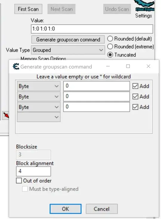

So, now we can switch over to CE and select Grouped scan so we can search for grouped values. In our case we have a group of 3 values, each being 1 byte. So, this is how CE should now look like.
1enter image description here
Then I simply press on First Scan and CE will find any memory in the paint.exe address space where there are 3 bytes with 0 in them, equivalent to
someAddress   0x00
someAddress+1 0x00
someAddress+2 0x00
CE will find a lot of addresses where this byte pattern occurs because three zero bytes isn't very unique.
What I will do now is select another color in Paint and follow the same process, except at the end I'll press Next Scan instead of First Scan. What this will do is CE will look at all of the addresses it found with three zeroes, and it will look if any of them changed to your new grouped values. One of those addresses will now hold the three new grouped values, and CE will find it for you and you'll only be left with hopefully one address left. If you're left more than a few, you can repeat the process with a new color.
