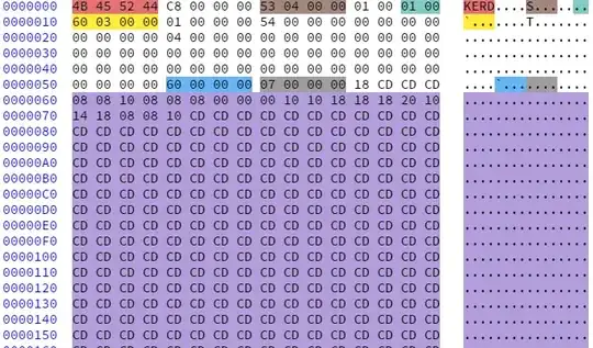

The first part of the file:
hex1
  • The red section is just some kind of file signature.
  • The brown part is the file length in bytes. (1107)
  • The green shows, how many images are stored in the file (currently one)
  • The blue part shows, where the table begins ( 0x60 = at the 96th byte)
  • The grey part shows, how long the content in the table is. Currently it's 7, so the table has 7*3 = 21 bytes, the other values are CD
  • The table is marked with purple
The second part of the file:
hex2
  • The blue part is the header of the image.
  • The yellow part shows, how long the image is (51bytes)
  • The red is the image width, and the brown is the height (3*9)
  • The 8 zero bytes (selected with green) are the same in each file.

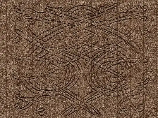

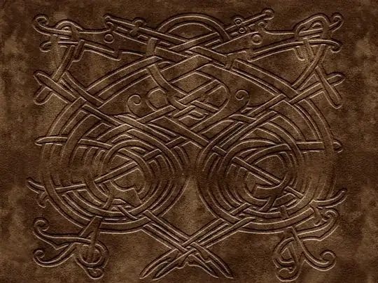

The bigger file has a resolution of 800*600 And I suspect it is this one (screenshot):
bacground
At the beginning (from 3C0), only the the first two or three bytes are set in each 4 byte group. From 0xD28, I cannot recognise any pattern.

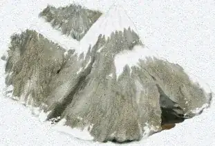

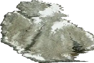

I've made some progress with the mountain, and the dragon.
I think, that the first 7 bits of the flag byte shows, on which x coordinate the line starts ( ´xstart = flag>>1;´ ). The least significant bit is a switch, which marks, that the line has this offset or not. You can try/edit the current code here: JSFiddle link
The result is this:
mountain_progress
The expected result would be similar to this (which is not far):
mountain
The distorted parts around the mountain are shadow/transparency, but I still wasn't be able to find any marks/flags about where the blocks with alpha values start and end.
Edit5:
I think, I've found a pattern in the mountain image. After the flag byte, the next byte may show, (flag2>>1), how many (Color, Alpha) blocks are at the beginning of the line.
The left side of the mountain looks slightly better now:
mountain left
Unfortunately this change breaks the other images

First some input how I got here (for future readers trying to do the same for different format).
  1. Image Data size
    Comparing provided background image to its raw image size xs*ys reveal direct dependence Which implies no compression or one that has always the same pixel to data ratio. I was assuming No compression.

    I simply took your ScreenShot and compare first decoded pixel with its. Find the color index in palette matching the color from each image and spotted the difference is simple increment. So I firstly increment the color index while decoding And result was good. After some research I found out that palette data has 257 colors instead of assumed 256 at first so I change the palette offset to compensate (no need for color index change anymore) Implying the first color entry (skipped by offset change) is some kind of special color (see bullet #1). Latter I deduced it is not color at all and does not belong to palette data but to header data. Now the result is:
    final output
    If I would not spot the color dependency then I would do histogram for decoded and screenshot image and then analyze dependency on most occuring colors indexes hoping to spot some pattern.
  4. Comparison
    I pixel match the decoded image with your ScreenShot but the images are not matching. Possibly some post processing or lighting was applied to it or there is some mistake in the decoding. It is hard to decide as I have no access to the original App and or knowledge of its inner workings. You should check more Images to see if there are some artifacts or not. The small images are unusable as you do not know the content and also the size is small for any significant details to reveal ...

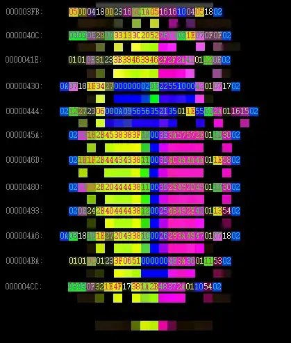

    After some thinking and looping in circles I create special debug views so I can see encoded image data , reference screenshot and the corresponding palette colors in some convenient way to spot patterns or dependency. The result was something like this:
    manual color cross-reference
    I simply render each pixel/BYTE of data as square with color corresponding to the palette entry and render the hex code inside. I render encoded ScanLine and screenshot ScanLine below (with cross matched color code from image palette printed inside. Then I painfully cross-reference both ScanLines in Paint and after comparing all the icons I got start deducing encoding format. The gaps means some kind of flag or prefix, sequence or special command. After implementing these rules into decoder then suddenly the images got looking much better.
    I got in a state where all the icons I got was pixel perfect but after more images came in (sprites) it was obvious that some codes may be variable and more in depth analysis of the chunks in file is needed to search for some code table or dictionary.
    To help with the analysis I rewrite the decoder debug view to separate class with capability to recognize perfect color match (square) and close color match (circle) to better asses the codes on non transparent pixels first.
    better debug view
    I started with rules like this:
    From it I deduced this (not fully OK see the code for actual state):
    first 2 Bytes are flags 03 unknonw flag/command skip flag can follow!
    • also end sequence 23 (flag and pixel follows as 01) 02 end of scanline 01 flag and pixel follows, end of sequence (if not in first 5 pixels) start of sequence: 13,17,23,27,2B pixel follows: 0D,0F,12,15,16,18,1A,1C,1D,1E flag or pixel follows: 06,07,0C,0E?,10
    • sequence can not start as first pixel otherwise it is pixel
    • sequence can stop after 5 pixels already done else 01/03 is just pixel
    I improved it much more later directly in the decoder

Here some previews:
new previews
And the Dragon frames:
dragon frames

Spektre
  • 1,384
I was able to decode the images. Spektre did a great job detecting the files structure, and the debug view was really helpful in the process. I implemented the algorithm in JS, and the source code is available here: https://github.com/K-Adam/DrekDecoder
Summary
Each line starts with a flag byte. It tells the decoder how many pixels to write and which mode to use. There are three possible write modes:
  • Opaque
  • Transparent
  • Skip
In opaque mode each pixel is represented by one byte, which references an RGB color in the palette. In transparent mode, the pixels are pairs of bytes: [Alpha, ColorIndex]
After each sequence a control byte follows. Its structure is different from the flag byte, and also different in each writing mode. This control byte will tell how many pixels to write and which mode to use next, or if the end of the line is reached.
Details
Flag byte
If the flag is zero (flag == 0x0), then the line is empty.
If the LSB is set (flag & 0b1) then there is an offset at the beginning of the line, and the decoder will start in Skip mode. The rest of the bits will represent the length of the offset (flag >> 1) + 1
If the second bit is set then transparent, otherwise opaque mode will be used:
mode = (flag & 0b10) ? Transparent : Opaque
The number of pixels can be found in the 5 MSB (flag >> 3) + 1
Skip mode
The decoder will simply write n empty pixels to the output. The next byte will be a control byte.
If LSB is set, then the decoder will switch to transarent mode. The other 7 bits represent the number of transparent pixels.
If the three LSB is 0b100 then the decoder will continue in Skip mode, otherwise it will change to Opaque mode. The other bits represent the number of pixels (vv >> 3) + 1
Opaque mode
Each data byte references an RGB color in the palette.
If the LSB is set, then the decoder will switch to transparent mode for (v1 >> 1) + 1 pixels. Otherwise the three LSB of the control byte is the flag:
  • 0b000 End of line
  • 0b110 Continue in opaque mode
  • 0b100 Switch to skip mode
The rest is the number of pixels (v1 >> 3) + 1.
Transparent mode
The transparent blocks are represented by sequence of pairs: [Alpha, Color]. The 5 MSB of the alpha byte is the transparency (0-32). The color byte references an RGB color in the palette.
The two LSB of the control byte is a flag:
  • 0b10 End of the line
  • 0b11 Switch to opaque mode
  • 0b01 Switch to skip mode
  • 0b00 Continue in transparent mode
The rest of the bits is the number of pixels (v1 >> 2) + 1, except for transparent mode, where it is (v1 >> 3) + 1
Decoding process
Since the colors are referenced by index, two bytes are needed to represent a transparent pixel. By looking at the bottom-left part of the mountain, it was clear from those alternating patterns, that it has to be transparent there. The colors around the round icons were also not right, so I suspected that the outer pixels are half transparent as well.
In the large image 0xFE appears after each 32 bytes. It does not reference a color from the palette, so it has to be some kind of control byte.
Then I started to write down the bytes in binary, where the color seemed not right. I grouped these values by where by where they appear, and then I spotted, that the least significant bits are similar on the boundary of transparent and opaque regions.
After further analysis, when I was able to decode the smaller icons by hand, I implemented the algorithm, and tested it for larger ones. From there, it was easy to eliminate the remaining anomalies in the result.
