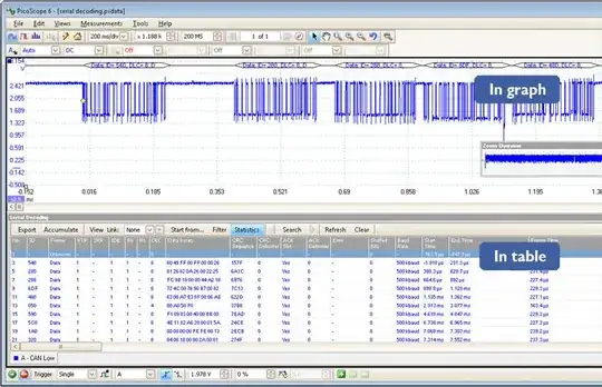

To test if a signal is really a serial signal, I typically use a scope. They don't cost you an arm and a leg these days; the one I currently use is this. (I have no affiliation with them except being a satisfied customer). To qualify as a serial signal, your signal should have sharp, straight vertical edges, and the time between two raising edges will be very constant. From this time, you can determine the baud rate (for example, ~100 µs between edges => ~1 ms per 10-bit-byte (8 bits + start bit + stop bit) => 1000 bytes per second => probably 9600 baud).
My answer to this question shows what is most probably not a serial signal; this is what a serial signal looks like (source):
