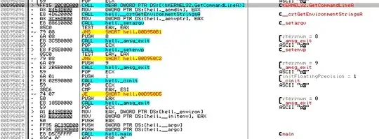

the same area and the distance between exec_main and getcommandline function as an image of ollydbg debugging the same executable
the same src built with debuginfo /Zi msvc compiler and snap shotted enter image description here
