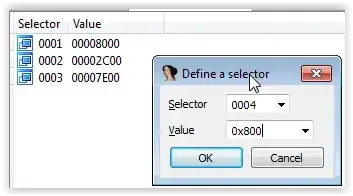

So far, it seems I have accomplish 50% of what I need by doing the following:
  1. Creating a new selector using the Selector subview: View > Open Subviews > Selectors.
  2. Right-click in the subview, select Add Selector.
  3. Created some examples as per figure 1 below.

Figure 1: Figure 1: Creating a new selector
