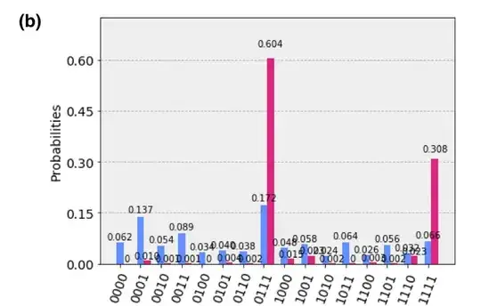

According to the article, results after measurement should be these:
Article result
Note that pink bars are results obtained on simulator, while blue ones on IBMQX2 processor.
Based on these results, the authors concluded that the largest eigenvalue is approximated by value $0.111_2$ (0.875 in decimal which is close to actual value 0.8576).

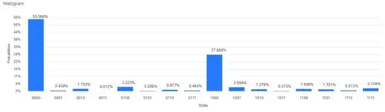

I received these results on IBM Q simulator.
My results
According to my results, the largest eigenvalue should be zero which does not make sense.
