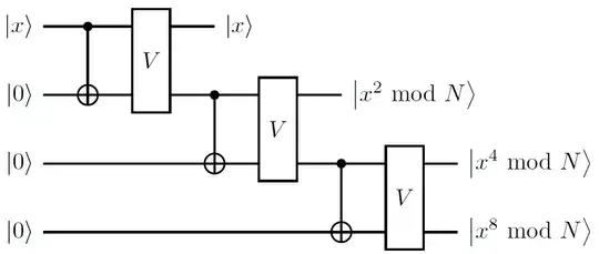

Here's, surely, a very non-optimal way of doing it. Imagine we have a unitary $V$ which performs the operation $$ V|x\rangle|y\rangle=|x\rangle|xy\text{ mod }N\rangle. $$ We can deal with how $V$ might work separately, but if you have that, we want to see how we can use it to calculate any $|x^{2^i}\text{ mod }N\rangle$. The trick is that if both inputs are $x^{2^j}\text{ mod }N$, then the output is $x^{2^{j+1}}\text{ mod }N$, so we only have to repeat this construction $i$ times. For example, in the circuit below: enter image description here Here, I've used the control-not to denote transversal application to achieve copying of one (effectively classical) register to another. This lets you do any of the $U$ operations that you need, assuming that you know how to implement $V$. Don't forget that, as part of a larger circuit, you have to 'uncompute' the data on any auxiliary registers.
So, how do we implement $V$? Let me give some of the components. Let $x=x_1x_2x_3\ldots x_n$ and $y=y_1y_2\ldots y_n$ be the binary representations of $x$ and $y$. The product $xy$ is easy to calculate by long multiplication. For example, $x_iy_j$ is a bit value (so there are never any carries from the multiplication steps) that is equivalent to applying the Toffoli (controlled-controlled-not) with $x_i$ and $y_j$ as the two inputs. So you can calculate $y_1x$, $y_2x$, $y_3x\ldots$ on separate registers and then add them up.

  • Thank you for your answer. I still have 2 problems though:$\$
    1. I'm still not sure how we can use multiplication and addition to make a circuit that calculate modulus. I'm a physics student and I don't really know about circuit. Can you elaborate for me?
    $\$ 2. This method looks like it's gonna take a massive number of qubits since we effectively just multiply everything out instead of doing memory-efficient modular arithmetic right? I estimated using 30 qubits just to store the $x^j$ answer if we were to do $19^7 \mod(21) = 1$. So this is definitely unusable as of right now right?
    – Jack Nathan Jul 24 '19 at 12:47
    @D.Tran You didn't ask for usable. You asked for a general method that could get you started. All the methods that have been used have involved a very deliberate choice of $a$ that makes things easy, and some very specific improvements for those cases. – DaftWullie Jul 24 '19 at 12:59
  • Yes, the 2nd question isn't too important, but as in the 1st one I'm still not sure how to use it to do modulo... – Jack Nathan Jul 24 '19 at 13:18
    @D.Tran Functionally, what is it you would do if you were asked to calculate $x\text{ mod }N$, given $x$ and $N$? – DaftWullie Jul 25 '19 at 07:17
  • If I were to do it by hand, I'll try to divide x to N, then multiply N by the rounded down result, then take x minus the multiplied result. – Jack Nathan Jul 25 '19 at 08:55
  • @D.Tran So make a circuit that does that... – DaftWullie Jul 25 '19 at 09:17
  • @DaftWullie "just draw the rest of the owl" – MaiaVictor Aug 10 '22 at 05:49
