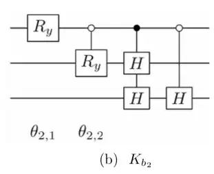

I'm implementing a quantum circuit in qiskit for a Szegedy quantum walk, (reference, Fig 21.). It uses two registers of dimension $N$ ($N=3$) each one. The challenges I'm facing are:
  1. Multiple controlled gates (2 and 3 controls and targets like $H$, $R_{y}$).
  2. Hermitian conjugate of an operator (Dagger).
  3. Ancilla qubits, that increase the complexity of the circuit.
Here is a main part of the circuit:
circuit
For example, we have $K_{b_{2}}$ controlled by zero and one controls.
This is the K_{b_{2} without dagger}
Main questions
  • How do I implement the controlled-dagger operator $K^{\dagger}_{b_{2}}$, of operator $K_{b_2}$? Does qiskit provide dagger operators of the principal gates? I have a little insight here. Should I apply tdg to all gates in $K_{b_{2}}$?
  • For multiple-controlled qubits operations, I base the construction of the multiple-controlled gates in the Nielsen&Chuang book, as Toffoli gates. So, we must use ancilla qubits. For $N$ controls we use $N-1$ ancilla qubits.
  • Is the following proposal correct?
proposition
So, for $K_{b_{2}}$, I control individually all the gates as follows, is this approximation correct?
K_{b_{2}}
How do I control the $R_{y}$ gate? I could not find a Controlled rotation around Y-axis only for Z axis (crz).
qiskit
I would define for each gate of the above figure, the "compute-copy-uncompute" method here.

This is an interesting question here.
The dagger operation is quite simple to implement and can be seen as a recursive operation.
The only requirement is that the dagger of each gate in your gateset is also in your gateset. This means that if $U$ is a gate in your gateset (i.e. a "primitive" gate), then $U^\dagger$ should also be present in your gateset.
If this requirement is checked (and it is checked for IBM gateset, which is the answer to your second question), then here is a pseudo-algorithm using Python syntax implementing a generic dagger operation:
def dagger(quantum_gate):
    if quantum_gate in gateset:
        return quantum_gate.dagger() # just returning a gate from the gateset.
    # else, quantum_gate is a sequence of other quantum gates (primitive or not)
    daggerized_gate = []
    for gate in reversed(quantum_gate):
        daggerized_gate.append(dagger(quantum_gate)) # recursive call
    return daggerized_gate
This algorithm is fully-generic: it works for every gates, even for controlled ones, provided the requirement is checked.
There are several algorithms that implement a generic $N$-controlled (controlled by $N$ qubits) $X$ gate. As far as I know, there are 3 distinct classes:
  1. The algorithms requiering $N-1$ ancilla qubits as you mention. These algorithms have the best gate-count and circuit-depth complexity.
  2. The algorithms requiering only $1$ ancilla qubit, at the expense of a bigger gate-count and circuit-depth.
  3. Hybrid algorithms between the 2 previous classes: they need more than one ancilla qubit but less than $N-1$ and also have a gate complexity between the 2 previous classes.
I don't have links right now, but will edit as soon as possible to provide you links to papers describing algorithms in the 3 previous classes.
Note: if someone has access to some papers, please edit my answer if possible or leave the link in comments.
K_{b_{2}}
This is not an approximation: it is 100% correct. Controlling a composed-quantum gate is equivalent to controlling all the gates composing it (may be used recursively).
About the implementation of the $R_y$ gate, you can implement it with the circuit given here.
Implementation of the controlled-Ry gate
For multiply-controlled $R_y$ gates, you can apply this definition recursively.
A quick observation: you can remove the 3rd control from the last 2 $H$ gates. If the first 2 controls are verified, the $H$ gate will be applied only once to the last qubit, independently of the value of third control-qubit.

  • A great answer @sanchayan-dutta.. About the implementation of the controlled-$R_{y}$, I found a reference here implementing it with a cnot and a u3 rotation (y-rotation) is it that simple? How I make this controlled-gate a dagger gate. I think that this is the only gate that is needed daggerized (I see that the Hadamard $H=H^{\dagger}$ ). – German Alamilla Jun 17 '19 at 06:11
  • The answer you found seems valid. I will correct my answer once I verified it fully. – Adrien Suau Jun 17 '19 at 06:58
    About inverting the $R_y$ gate, you just have to invert the angle of rotation: if you want to invert an arbitrary rotation, then apply that same rotation but with the inverse angle (i.e. in the other direction). – Adrien Suau Jun 17 '19 at 07:27
  • can you provide any resource for the recursive multiple-controlled $R_{y}$ gates? – German Alamilla Jun 17 '19 at 23:54
  • Also, any hints about using barriers, should I place a barrier after each controlled-operation? – German Alamilla Jun 18 '19 at 00:44
