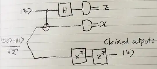

Had some fun this afternoon re-analyzing the circuit for quantum teleportation. Here's a proof I found that the circuit works.
The circuit to be verified: top two qubits are Alice's, including the state psi to be teleported. Bottom qubit is Bob's - want to show it outputs psi.
I would appreciate if someone can explain and elaborate on the steps for the proof? Also what do the $X^x$ and $Z^z$ gates mean?

$x$ and $z$ are just numbers $0$ or $1$, so $X^x = I$ or $X$, and $Z^z = I$ or $Z$.

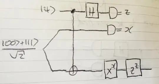

  1. The first step is to note that in our case CNOT operation on the 1st and 2nd qubits has the same effect as CNOT on the 1st and 3rd qubits. That is $$ CNOT_{12} |\psi\rangle(|00\rangle+|11\rangle)\frac{1}{\sqrt{2}} = CNOT_{13} |\psi\rangle(|00\rangle+|11\rangle)\frac{1}{\sqrt{2}} $$ To see why, just define $|\psi\rangle = \alpha|0\rangle + \beta|1\rangle$ and compute $$ CNOT_{12} |\psi\rangle(|00\rangle+|11\rangle)\frac{1}{\sqrt{2}} = CNOT_{12}(\alpha|0\rangle + \beta|1\rangle)(|00\rangle+|11\rangle)\frac{1}{\sqrt{2}} = $$ $$ =CNOT_{12}(\alpha|000\rangle + \alpha|011\rangle + \beta|100\rangle + \beta|111\rangle )\frac{1}{\sqrt{2}} = $$ $$ = (\alpha|000\rangle + \alpha|011\rangle + \beta|110\rangle + \beta|101\rangle )\frac{1}{\sqrt{2}}, $$ $$ CNOT_{13} |\psi\rangle(|00\rangle+|11\rangle)\frac{1}{\sqrt{2}} = CNOT_{13}(\alpha|000\rangle + \alpha|011\rangle + \beta|100\rangle + \beta|111\rangle )\frac{1}{\sqrt{2}} = $$ $$ =(\alpha|000\rangle + \alpha|011\rangle + \beta|101\rangle + \beta|110\rangle )\frac{1}{\sqrt{2}} $$ So, we can transform the circuit by switching $CNOT_{12}$ to $CNOT_{13}$. enter image description here
  2. In the second step we note that in our new circuit the second qubit has only one operation that affects it – the measurement. So we can apply it before all other operations. The result of this operation is $x=0$ or $1$, and 2nd and 3rd qubits after this measurement will be $|xx\rangle = |00\rangle$ or $|11\rangle$. enter image description here

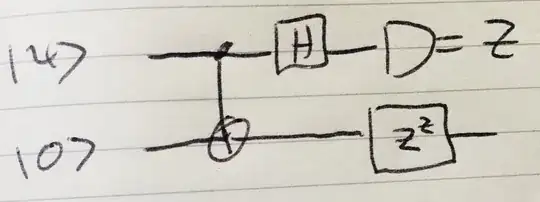

  3. Since the 3rd qubit is $|0\rangle$ or $|1\rangle$ at this step, we can swap the order of operations $CNOT_{13}$ and $X^x$ on it. But $X^x|x\rangle = |0\rangle$, so what is left is to analyze the circuit enter image description here
  4. At this step you can directly compute the effect of the CNOT and H gates $$ H\otimes I \cdot CNOT_{12} \cdot |\psi\rangle|0\rangle = H\otimes I \cdot CNOT_{12} \cdot (\alpha|00\rangle + \beta|10\rangle) = $$ $$ = H\otimes I (\alpha|00\rangle + \beta|11\rangle) = \frac{1}{\sqrt{2}}\left( \alpha(|0\rangle+|1\rangle)|0\rangle + \beta(|0\rangle-|1\rangle)|1\rangle \right) = $$ $$ = \frac{1}{\sqrt{2}}\left( \alpha|00\rangle+\alpha|10\rangle + \beta|01\rangle-\beta|11\rangle \right) = \frac{1}{\sqrt{2}}\left( |0\rangle(\alpha|0\rangle+\beta|1\rangle) + |1\rangle(\alpha|0\rangle-\beta|1\rangle) \right) $$
  5. Now if we measure 1st qubit the result will be $z=0$ or $1$, and the state will be $|0\rangle(\alpha|0\rangle+\beta|1\rangle)$ or $|1\rangle(\alpha|0\rangle-\beta|1\rangle)$ correspondingly. So if we apply $Z^z$ on the last qubit it will be in the state $\alpha|0\rangle+\beta|1\rangle = |\psi\rangle$
