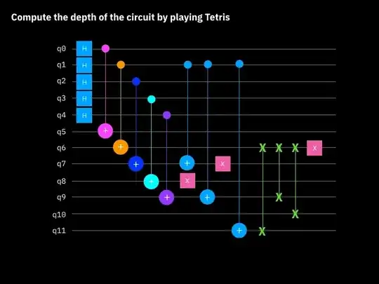

It is hard to beat the animation present in the Qiskit documentation at https://docs.quantum.ibm.com/api/qiskit/0.42/circuit (and in the source tree here) where they describe depth finding as "playing Tetris" and which gives a good intuition about the algorithm:
This suggests the following algorithm:
  • create a linear list of all the gates as they are applied
  • merge gates into the lowest layer as much as possible as long as each gate does not touch a qubit already used up the the layer
  • when a gate arrives that already has one of its qubits used in the top layer, create a new layer and repeat
