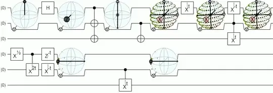

For pure states, there is a reasonably simple way to make a "2 qubit bloch sphere". You basically use the Schmidt decomposition to divide your state into two cases: not entangled and fully entangled. For the not-entangled part, you just use two bloch spheres. And then the entangled part is isomorphic to the set of possible rotations in 3d space (the rotation is how you translate measurements on one qubit into predictions on the other qubit). This gives you a representation with eight real parameters:
1) A real value w between 0 and 1 indicating the weight of not-entangled vs fully-entangled.
2+3) The not-entangled unit bloch vector for qubit 1.
4+5) The not-entangled unit bloch vector for qubit 2.
6+7+8) The fully-entangled rotation.
Here's what it looks like if you show the rotation part as "where X Y and Z axes get mapped", and additionally scale the axes by w so that it gets bigger the more entangled you are:
entangled view
(The bouncing in the middle one is due to a numerical degeneracy in my code.)
For mixed states, I've had a bit of success showing the envelope of bloch vectors predicted for qubit 2 given every possible measurement of qubit 1. That looks like this:
mixed state envelope
But note that a) this 'envelope' representation is not symmetric (one of the qubits is the control and the other is the target) and b) although it looks pretty it's not algebraically compact.
This display is available in the alternate dev-entanglement-display branch of Quirk. If you're able to follow the build instructions, then you can play with it directly.
