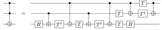

A recent question here asked how to compile the 4-qubit gate CCCZ (controlled-controlled-controlled-Z) into simple 1-qubit and 2-qubit gates, and the only answer given so far requires 63 gates!
The first step was to use the C$^n$U construction given by Nielsen & Chuang:
With $n=3$ this means 4 CCNOT gates and 3 simple gates (1 CNOT and 2 Hadamards is enough to do the final CZ on the target qubit and the last work qubit).
Theorem 1 of this paper, says that in general the CCNOT requires 9 one-qubit and 6 two-qubit gates (15 total):
This means:
(4 CCNOTs) x (15 gates per CCNOT) + (1 CNOT) + (2 Hadamards) = 63 total gates.
In a comment, it has been suggested the 63 gates can be then further compiled using an "automatic procedure", for example from the theory of automatic groups.
How can this "automatic compilation" be done, and how much would it reduce the number of 1-qubit and 2-qubit gates in this case?
