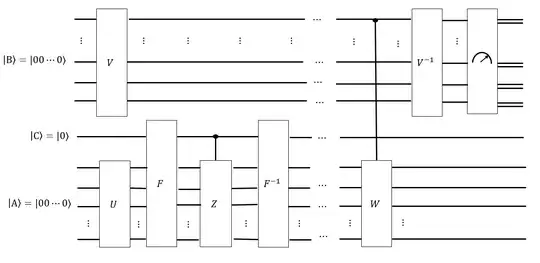

Initially let's consider some registers and operators.
  1. The register $\vert A\rangle$, which encodes superpositions of states of the cube (e.g. a permutation of the cube $G$);
  2. The operator $U$, which acts on $\vert A\rangle$ to map the all-0's ket $\vert 00\cdots 0\rangle$ to the uniform superposition over all $\Vert G\Vert$ states;
  3. The register $\vert B\rangle=\vert b_1\rangle\vert b_2\rangle\cdots\vert b_k\rangle$, which encodes superpositions of a set of Singmaster moves to be applied to a given position (e.g., superpositions of words of Singmaster moves of length $k$);
  4. The operators $V$ and $V^{-1}$, which act on $\vert B\rangle$ to map the all-0's ket $\vert 00\cdots 0\rangle$ to the uniform superposition of all $18^k$ words of Singmaster moves of length $k$ (and vice-versa); and
  5. The (controlled) operator $W$, which applies Singmaster move $b$ to to a given cube position.
If $\vert A\rangle$ is in the uniform superposition over all elements of $G$, then $\vert A\rangle$ is in an eigenstate of $W$, and repeated applications of $W$ will not be kicked back to affect $\vert B\rangle$.
Circuit that does not change the state
That is, $V^{-1}$ should return $\vert B\rangle$ in the above circuit to the all-zeroes ket $\vert 00\cdots 0\rangle$.
However, as noted by @DaftWullie, if $\vert u\rangle$ is not in an eigenstate, then a difference between $\vert u \rangle$ and $\rho^k \vert u\rangle$ builds up very rapidly - I believe a speed at which this difference builds up depends precisely on the mixing properties of the operator of interest.
Thus, if we are able to prepare a state $\vert A\rangle$ that is perturbed from the uniform distribution, such that $\vert A\rangle$ is not an eigenstate, then repeated applications of $W$ will rapidly build a difference, and $V^{-1}\vert B\rangle$ may not be the all-zeroes ket.
Revised circuit showing better approach
If we had a function $F$ acting on $\vert A\rangle$ and an answer qubit $\vert C\rangle$ that determines, say, whether some hash $\{0,1\}^{\log_2 \Vert G\Vert}\mapsto (0,1)$ of the Rubik's cube position is less than some threshold $\delta$, and we use this $F$ to control a rotation of $\vert A\rangle$, then I believe that $V^{-1}\vert B\rangle$ in the circuit above will not read the all-zeros ket, and instead will likely deviate from the all-zeroes ket in a manner depending only on $\delta$ and the mixing time of the Rubik's cube group with the Singmaster generating set.
That is, I expect measurement of $\vert B\rangle$ in the above circuit will read $\vert 00000\cdots000101101\rangle$ or something similar, where the index of the first $1$ depends solely on the mixing time and the threshold $\delta$.
