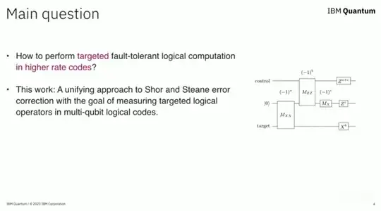

General states is impossible; your gate set must be discrete to have fault tolerance. Even preparing simple states is hard. It's still an open research question. For example, Tomas Jochym O'Connor's talk at the QEC 2023 conference was on this topic.
