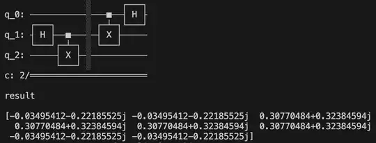

And then, by using a standard quantum teleportation circuit, I proceed with quantum teleportation.
#qc is stage1. generate Bell state and operate in Alice's side
qc = QuantumCircuit(3, 2,global_phase=0)
# Prepare an entangled Bell pair between Alice and Bob
qc.h(1)
qc.cx(1, 2)
qc.barrier()
# Entangle the state to be teleported with Alice's qubit
qc.cx(0, 1)
qc.h(0)
#evolve compound statevector through evolve method. compound_statevector = compound_statevector.evolve(qc) print(qc) print("result\n") print(compound_statevector.data)
Then I got below output. stage1
