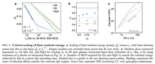

In April 2023, the D-Wave team put out a nature paper (arXiv version here) discussing how they used a D-Wave system to compute the ground state of a 3-D spin-glass Hamiltonian.
In particular (from my understanding) they use quantum annealing to solve many instances of small 3D spin glass models (16 particles) and a large one (128 particles). They benchmark their computation by by 1) using already established but very slow methods to solve the problem exactly and then 2) using several approximation methods (including quantum annealing) to see how much time it takes them to get a good enough approximate solution. The results are a bit difficult to interpret but it seems like quantum annealing gets them to the same “good enough” solution 10-20x faster than classical methods.
They also have more theoretical arguments for speedups. They plot the time it takes to perform (simulated and quantum) annealing for different levels of approximations. They then use fits and other theories to compute metrics like the Binder cumulant and KZ exponent and show that the time to solution scales as t^(-k) where k is bigger (0.7-1) for quantum annealing than for the other techniques (0.25-0.5). But to be honest, the details and methodologies of these arguments are outside my field of expertise.

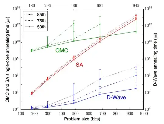

Google's quantum group demonstrated quantum advantage with a much earlier version of D-Wave hardware in the following figure from a 2016 paper, in which the D-Wave hardware found the ground state of Ising (spin glass) Hamiltonians involving up to 945 spins/qubits, about 7 orders of magnitude faster than the best they were capable of doing with classical computers (SA = simulated annealing, QMC = quantum Monte Carlo):
Hartmut Neven, the leader of Google's quantum group and the last author on the paper, said at the APS March Meeting in 2016 in front of a room that was so packed that people had to stand at the back due to a lack of enough seats, that Google spent about 1 million dollars on producing the green curve on classical supercomputers (notice that they gave up on completing the dotted line and dashed line for QMC).
If with quantum annealing you can solve a problem 10,000,000 times faster than you can with $1 million worth of classical supercomputer time, then the quantum annealer does have some type of advantage.

What have they done differently here compared to the aforementioned paper from 7 years ago? In both cases, they found the ground state of an Ising problem, although in the April 2023 case they didn't compare the speed to a classical computer, so they didn't demonstrate any quantum advantage. The precise number of qubits used was shockingly difficult for me to find, but based on pg 33 out of 45 it seems that they used 5374 qubits, so I do believe that their hardware found the ground states faster than a classical computer could have (just see the above figure and imagine what happens if it goes up to 5000 qubits and when the D-Wave hardware has likely improved significantly over the last 7 years for this specific task compared to classical hardware).
However, a 3D spin glass is just a spin glass (for which the same advantages were shown in the above 2016 paper). Perhaps for the 3D spin glass you are choosing to couples specific qubits together, in order to mimic a 3D lattice, but this is still just a special case of what could be done many years ago with the same hardware.
