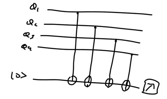

Following similar answer by @DaftWullie and @Tristan Nemoz on How to perform a state density modification for a single targeted state only? , I believe this can be done as follows:
Measuring the last bit will enforce the parity of the number of $|1\rangle$'s in $q_1q_2q_3q_4...$. If the measurement result is $|1\rangle$, discard and start over. If the measurement result is $|0\rangle$, then the remaining superposition must contain an even number of control $|1\rangle$'s in $q_1q_2q_3q_4...$ as desired.
There should exist more complex variations of this parity check to distinguish, for example, $0,1,2,3 \mod{4}$, i.e. the exact number of $|1\rangle$'s in $q_1q_2q_3q_4$...

    Don't forget the Hadamard gates at the beginning! :D And I don't think this approach works well here. Each time you're checking a parity, there's a $\frac12$ probability of starting over. Thus, the probability of success of this approach seems to be $\frac{1}{2^{\log n}}=\frac1n$. A direct projection isn't good either: if $h$ is the hamming weight, the projection will succeed with probability $\frac{\binom{n}{h}}{2^n}$.
    Fortunately, we do know an efficient deterministic construction for the case with $h=1$. For the other cases, see the discussion in the question I've linked in the comments.
