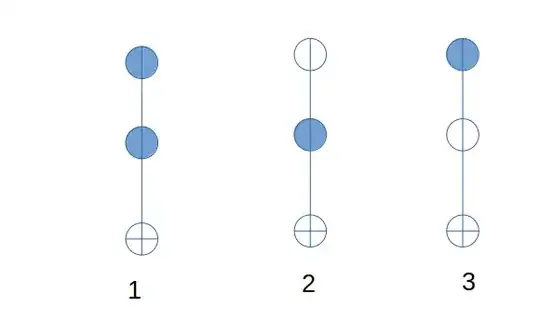

Here are the different toffolis (or maybe one of them is toffoli and the others are very similar to toffoli gates)
My question is:
  1. we know the matrix of the number 1 Toffoli:
What are the matrices for other two toffoli gates?

  • I would recommend to write down a map how three-qubit basis states (000, 001, 010, 011, 100, 101, 110, 111) are changed with the gates. Then convert the resulting basis states to vector representation and put them into a matrix (as columns) in the same order as the input states in the bracket above. – Martin Vesely Nov 28 '22 at 07:10
    An answer to a very similar question which will show you how to answer your own question :) https://quantumcomputing.stackexchange.com/questions/28315/how-to-calculate-cnot-gate-for-three-qubit-1-control-2-target-states-as-a-mat/28347#28347 – sheesymcdeezy Nov 28 '22 at 12:49
  • very helpful, thanks :) – quest Nov 28 '22 at 23:15

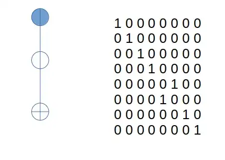

The problem is much easier to think about in turns of permutations. You can see that the matrix you created simply swaps the last two elements of the statevector: $[a_{000}, a_{001}, a_{010}, a_{011}, a_{100}, a_{101}, a_{110}, a_{111}]$ becomes $[a_{000}, a_{001}, a_{010}, a_{011}, a_{100}, a_{101}, a_{111}, a_{110}]$
The middle gate above swaps $a_{010}$ and $a_{011}$. The right gate swaps $a_{100}$ and $a_{101}$. The matrix is the identity matrix, but the two $1$s corresponding to these two rows are moved to the opposite corners of the square they are corners of.
And yes, the two gates, together, make an odd parity check.
Frank Yellin
  • 713
  • From the three examples you have, you should be able to understand the pattern of which two states swap on a CNOT. I really think you should figure this out for yourself, to show you understood my answer. – Frank Yellin Nov 28 '22 at 17:46

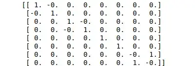

Thanks to @Rajiv Krishnakumar, I solved the problem by this link Here are my toffolis: enter image description here
enter image description here The other two toffoli was already found yesterday: enter image description here

I always find enlightening the block-matrix display approach, so that these three Toffoli operators can be viewed as
$$\begin{bmatrix}I& & & \\ &I& & \\ & &I& \\ & & &X\end{bmatrix}$$ $$\begin{bmatrix}I& & & \\ &X& & \\ & &I& \\ & & &I\end{bmatrix}$$ $$\begin{bmatrix}I& & & \\ &I& & \\ & &X& \\ & & &I\end{bmatrix}$$
where $I$ is the $2$x$2$ identity operator, $X$ is the NOT operator, and the white spaces are all zeroes for tidyness.
